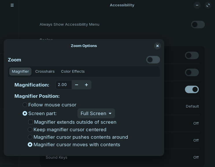

Did you enable this setting ... Settings-> Accessibility-> Zoom ? Or is it a Chrome specific problem?
No, I did not enable the accessibility.

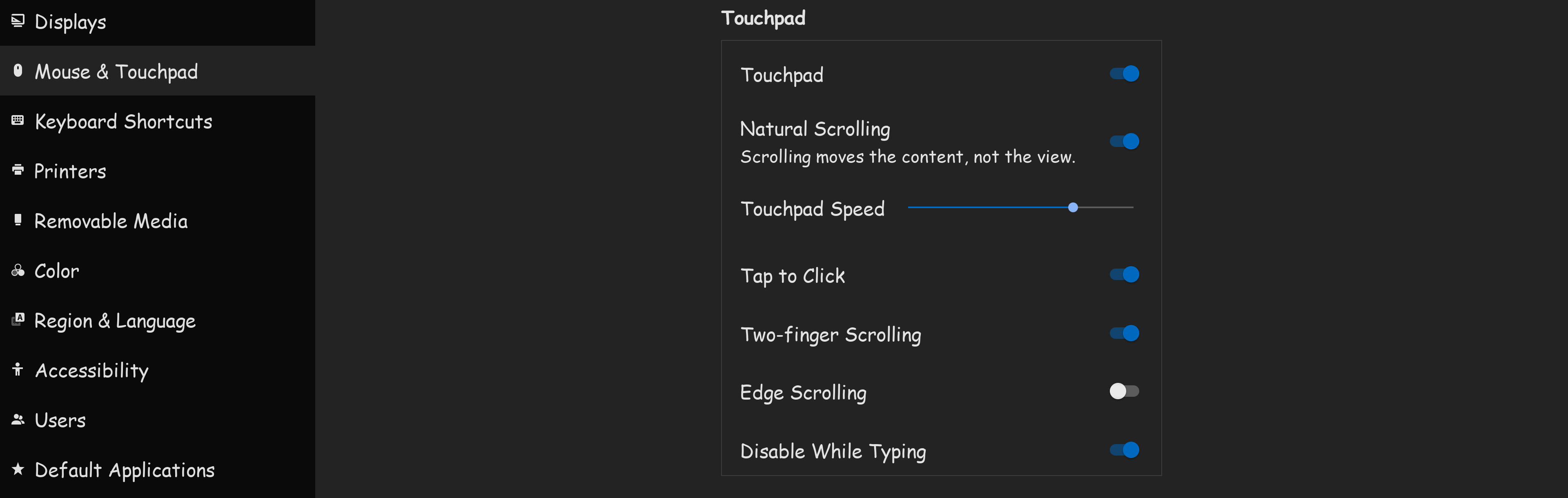

Did You take a Look in the Settings for the Touchpad Gestures?
Navigate to, Zorin :zorin: start menu, click on "settings," "Mouse & Touchpad". :gear: These are your available settings for your Touchpad.
I did. Wondering if I can install Touche or similar to give me the functionality I would like.
