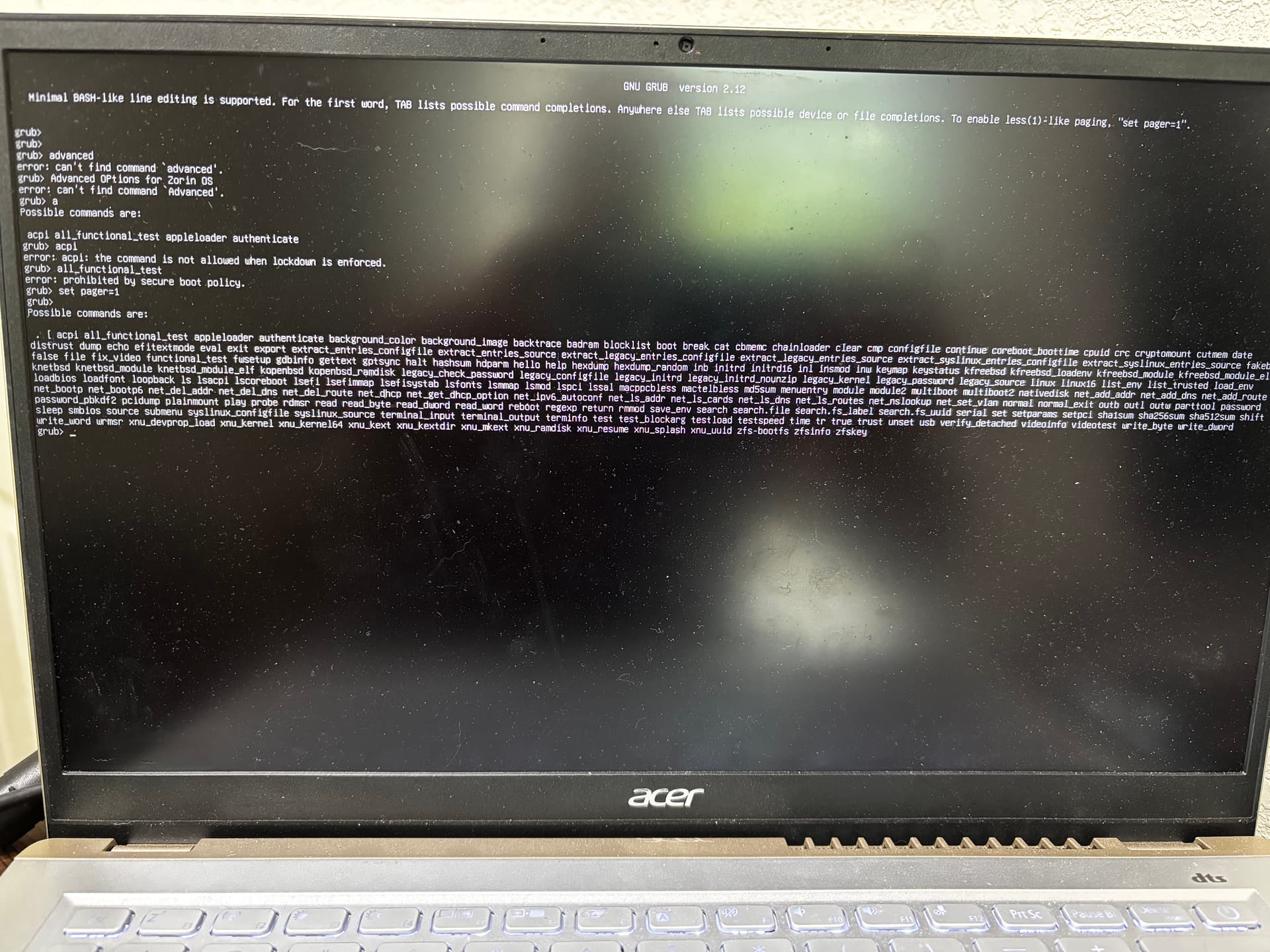

Can't enter GRUB menu with SHIFT key, but can with ESC key
But not presented with any menu options, only a "grub>" prompt
everything is locked down by secure boot policy
What's my next step?

If you fall to this screen it's because you type 2 times esc.
When you are on TTY (kind of terminal) just type normal to boot zorin.

I misunderstood "hold esc while booting"
Pressed ESC only once while booting
entered "Advanced options for Zorin OS"
selected the previous kernel without recovery
all my USB stuff is working now!
