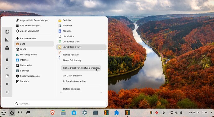

Is it possible to add an "Add to desktop" entry to the Arc menu context menu? This feature is available in the Zorin menu, but not in the Arc menu.
Which file determines the context menu?

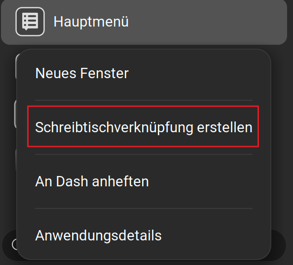

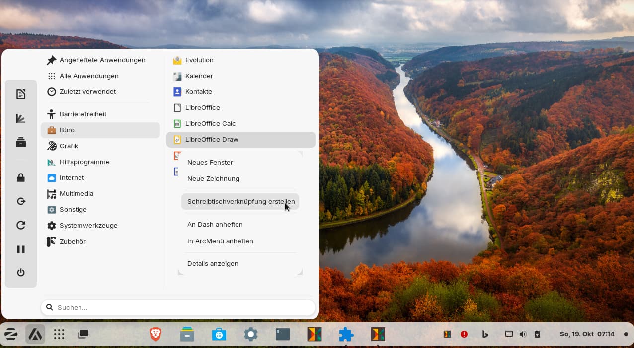

Are You on Zorin 18? I am. And have ArcMenu installed and use it. And I have the right-click Menu Option for a Desktop Shortcut:
Oh, that is interesting. No, I'm on Zorin 17.3. I only have the option to add an app to dash. Do you think it depends on the chosen layout in Arc menu?
No, I don't think so. On Zorin 17, I hadn't that Option, too. I think it is a Version Thing. On Gnome 43 ArcMenu ends with Version 48 and on Gnome 46 (Zorin 18) it is up-to-date. Maybe it was added in a later Version.

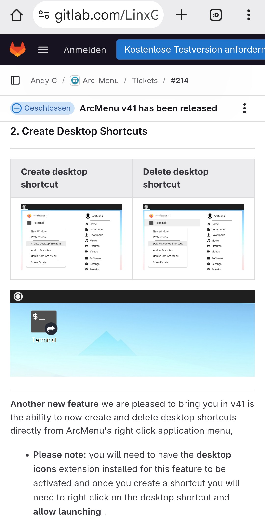

I found a solution. After reading that the function for creating a shortcut to the desktop has already been added in Arc Menu version 41 (and I use v.48), but that it requires the installation and enabling of the gnome extension desktop icons, I tried to see what would happen if I used the "Desktop Icons NG (DING)" extension instead of the "Zorins Desktop Icons" extension. And lo and behold: it works! Now I have the option to add apps to the desktop via the right-click menu also in Arc-Menu.
After adding the desktop shortcut, right-click on the icon on the desktop and select "allow launching."
I'm trying to figure out what I could change in the code in the json file so that the apps added to the desktop can be launched automatically, as with the Zorin menu, without having to set "allow launching" manually for each app.
It seems to me that this feature has been added in newer versions of ArcMenu:

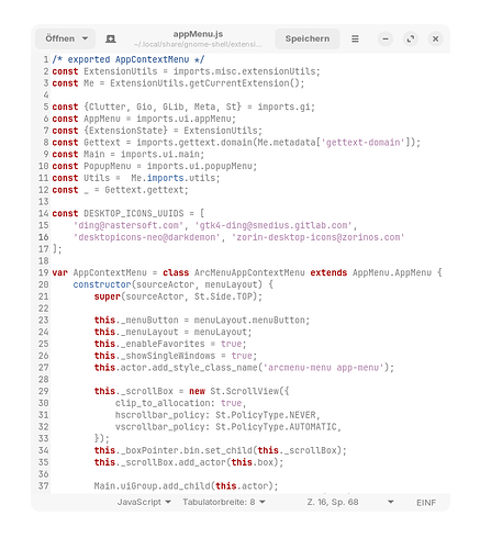

I found a solution so that it also works with gnome extension "Zorin Desktop Icons" and you don`t need to add another extension.

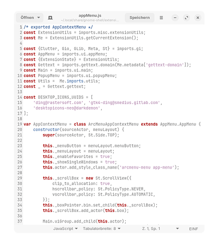

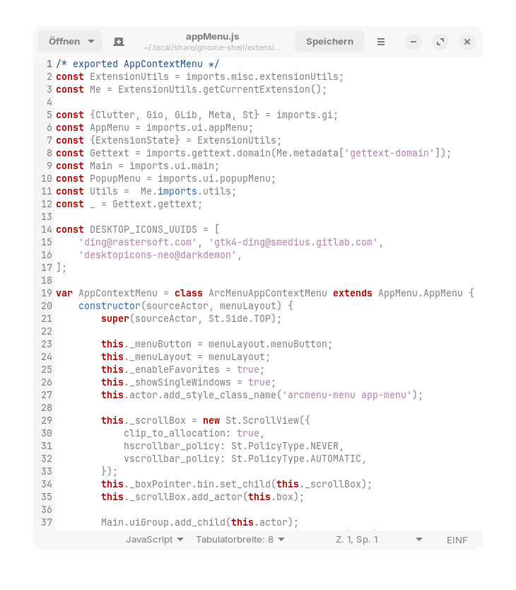

I edited the file
~/.local/share/gnome-shell/extensions/arcmenu@arcmenu.com/appMenu.js:
Original file:

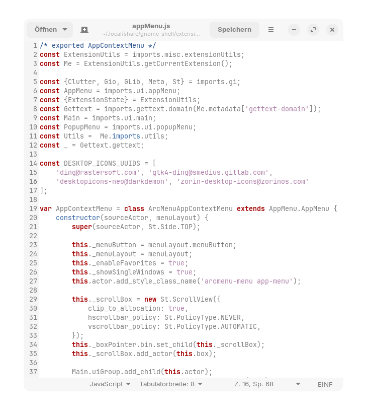

I changed line 16 and added 'zorin-desktop-icons@zorinos.com' to the const DESKTOP_ICONS_UUIDS. Here are all gnome extensions listed that work with ArcMenu to create desktop shortcuts:
For allow launching automatically I haven´t found a solution yet. Replacing the complete appMenu.js with the file of newer ArcMenu versions (link of my last post) didn´t work.
