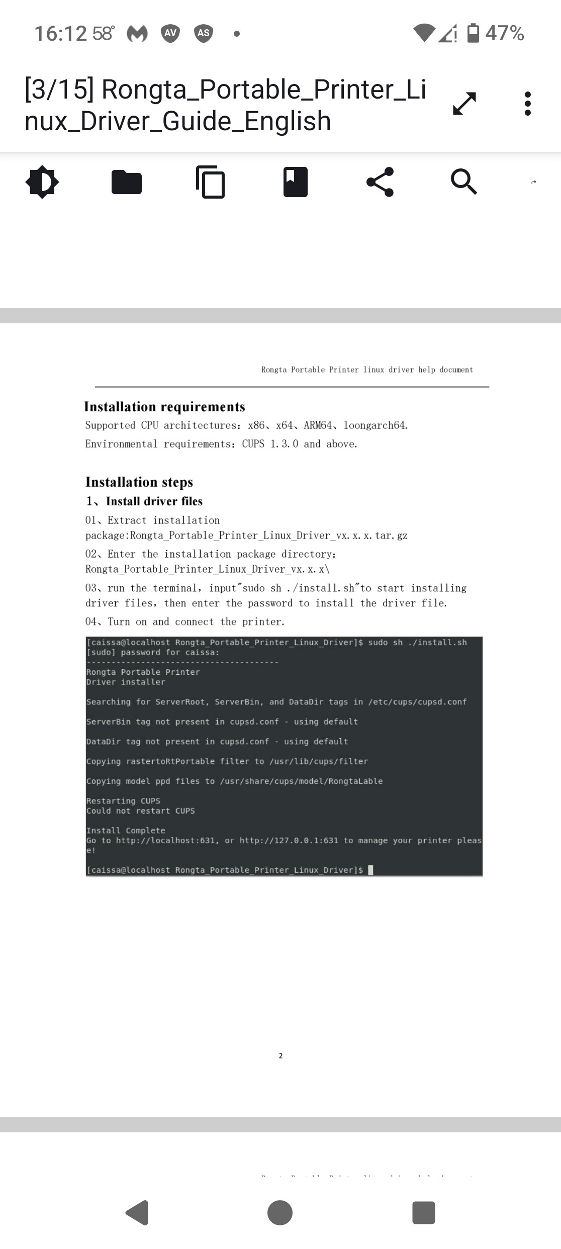

Just downloaded and extracted the .zip file on my phone. You need to make sure that cups-pdf is installed first before proceeding.
You need to navigate to the extracted folder and once you have navigated to it in the terminal enter:
sudo ./install.sh
once it has completed, then attach the printer and use CUPS administration link on http://localhost:631

Slight amendment to the sudo command in my first post (from the manual):
The manual is a bit of a joke as the download is a .zip file not a .tar.gz file. Clearly they haven't either updated the manual or different models have different compressed files.
@nite_route there are no .deb files.

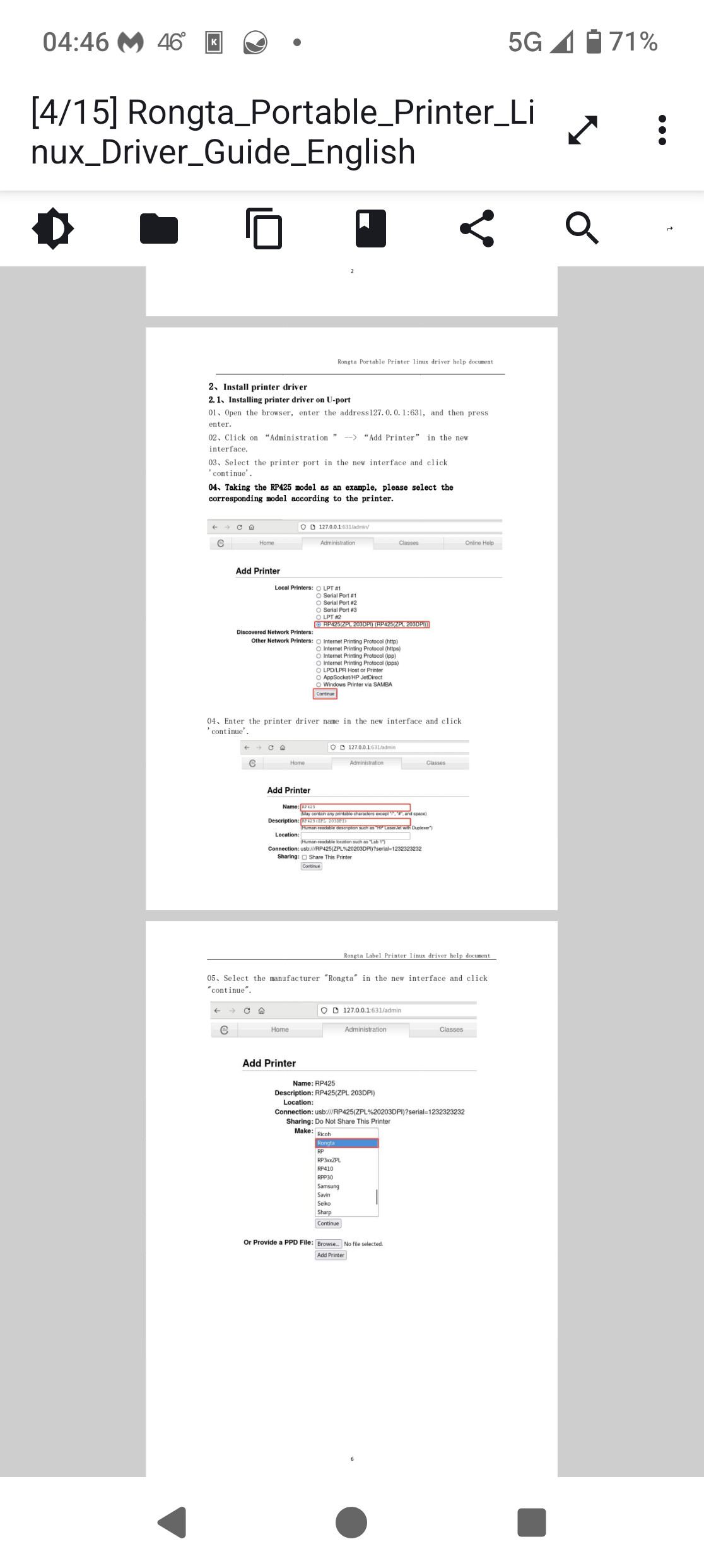

Hi, you need to start referring to the English manual that is included in the extracted .zip file an ensure you enter the correct model in the fields presented (they give an example of a different model):
