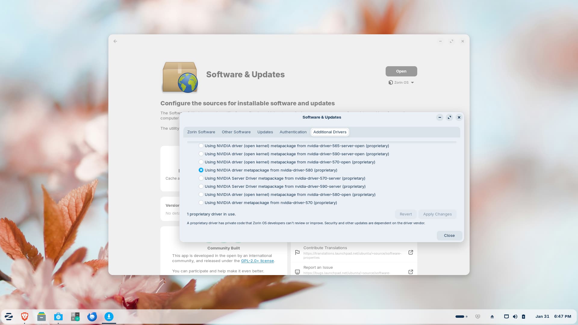

Screen shot
Finally found software and updates: additional drivers (not following help directions at all)
So it says driver is installed.
