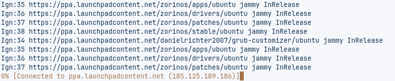

Not for me in the UK. I've tried local and main servers and I get nothing in Software, Software Updater and Terminal.
The Ubunto repos seem ok, but launchpad is still broken (for me).

I have tried diferent VPN locations etc, different download servers and mirrors, and nothing whatsoever works for me yet.
Oh this is ridiculous! Can anyone point me to a specific server that actually works? I've tried Main, UK, Italy, Germany - all of them useless.
Do You have a VPN active? If yes disable it. Then set up Main Server and use sudo apt update && sudo apt upgrade
Do You have made any Changes on the Sources? In which Country You are?
Wow the turn off VPN thing sorted it...eek. They must be putting restrictions on what they think might be block/network traffic.
Thank you. I disabled my firewall and things sprang back into action. I've never seen this in the six months I've used Zorin, and I've always been on a permanent VPN, either Proton or Nord. I guess I'll have to find a workaround - I don't want to spend ten minutes disabling the VPN every time I want to install an app. I wonder why this is suddenly happening now? Changes at Canonical's end?
