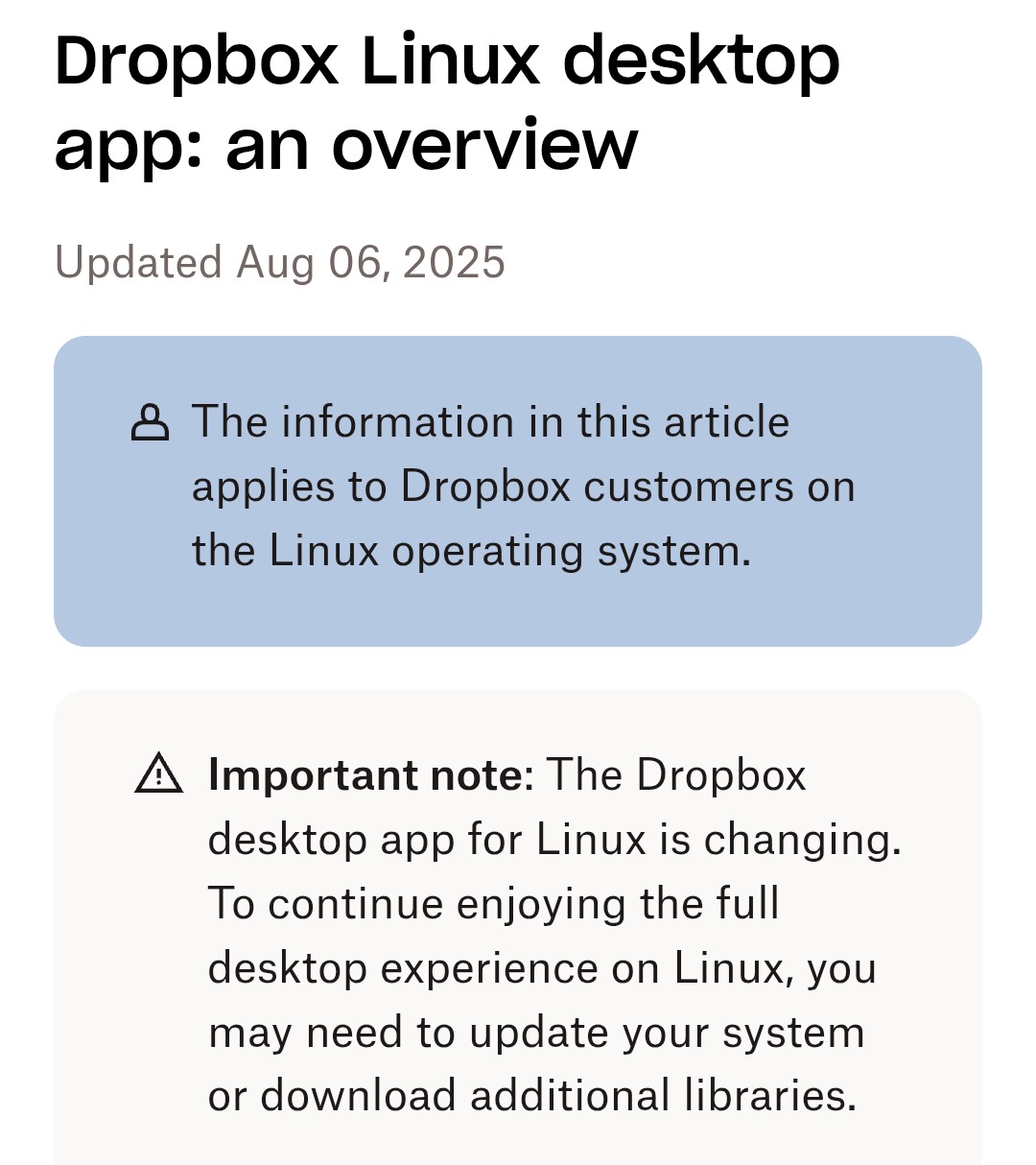

Maybe it only shows that gnome isn't officially supported and needs additionally appindicator. On the website there is reported that dropbox will be changed:
