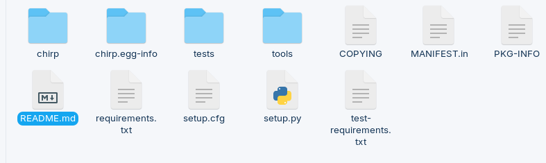

I downloaded the most recent version of the CHIRP application, which was in compressed tar.gz format. After extracting and changing to that folder, I did not find the typical 'Configure' file in preparation for the 'Make' command. The README file contained no pertinent information:

You need to run setup.py via the terminal to execute the compiling. There's different ways to set up the compiling of source codes.
I do not know much about CHIRP and without looking into this a great deal... my firs tsuggestion is that as I understand it, they do not release with a configure script because they expect a python install
sudo python3 setup.py install
Rather than
./configure
make
Make sure you have your dependencies, first for most any python install:
sudo apt install python3 python3-pip python3-serial python3-tk
Thanks. setup.py is an "unknown command"
It is not a standalone terminal command, but instead must be run using python, specifying the python version.
In this command, you are specifying for python3 to perform the action.
Thank you. Unfortunately, that still did not work. I gave up and bought a small used Windows 11 laptop specifically for programming my radios with CHIRP. After setting up the Win11 computer, I was able to finish programming the radio in about 15 minutes. Some things actually do work better under Windows 11.
