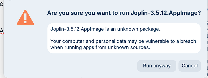

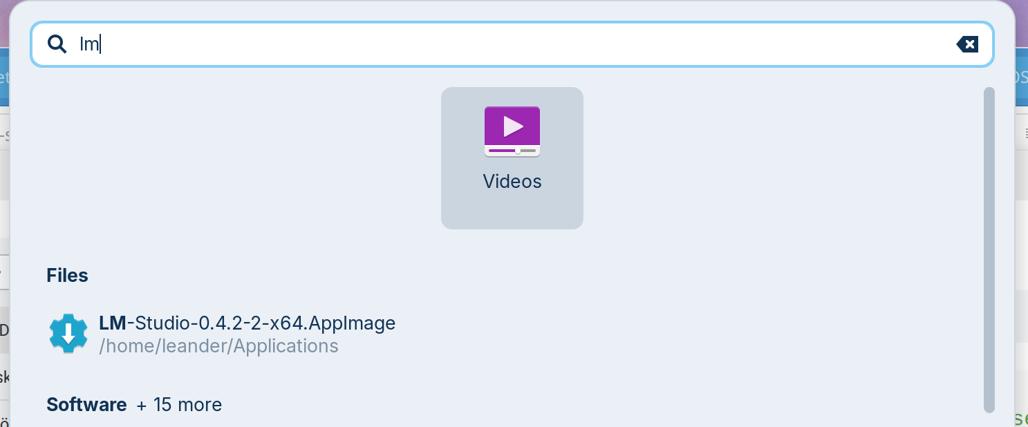

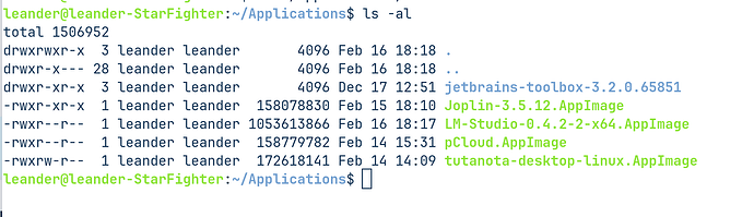

But I now have two more AppImages: Joplin and LM Studio which both are missing an app icon, they get the default "gear icon". I moved them to ~/Applications before running them the first time, so its not that their "meta data" was created for the wrong location. Is there anything can be done about this?

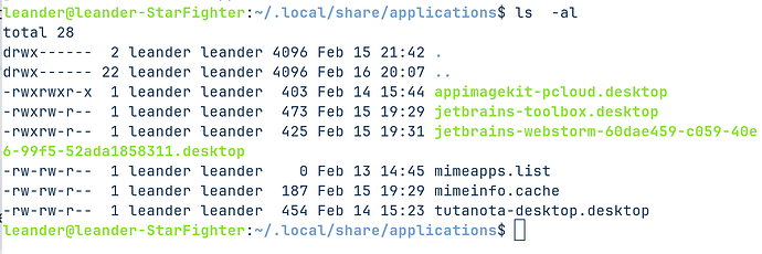

Did You checked if in ~/.local/share/applications/ are .desktop files for the Programs? Did the Programs already run one Time?

Thanks for the reply. Yes I ran them several times and I checked that folder, but there's nothing there. What I do notice is that I get the same message every time, as if I had never run them. Also they stay listed as files and not as apps when I use the Zorin menu.

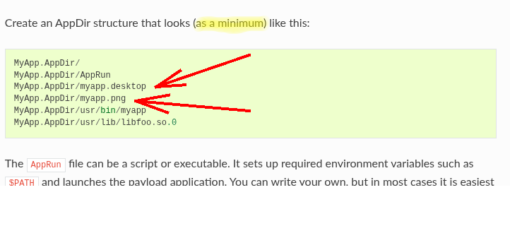

It's actually a standard; see the official documentation:
This doesn't mean those files will be copied to the system, but they should be present in the package. Otherwise, how would some external tools (like the mentioned gear lever ) manage it ?

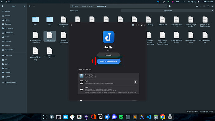

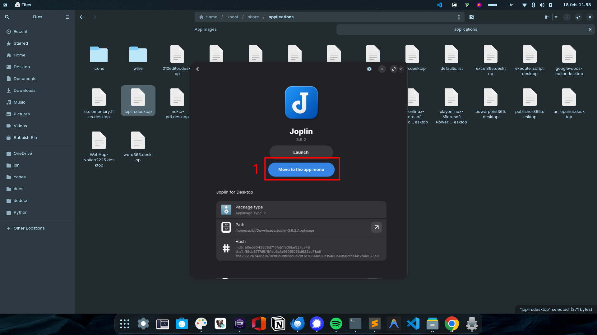

Probably you had another joplin desktop file on ~/.local/share/applications
When you click on Move to the app menu, it creates a desktop file on this folder.
You can find the old one of duplicate, remove the file and then run this on terminal:
update-desktop-database ~/.local/share/applications/
