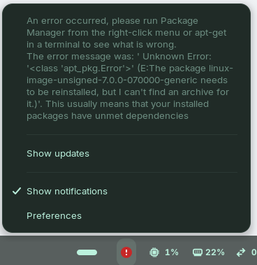

Well, this has led me down a different, but more unfortunate path. I tried installing 7.0 though I probably should have known better. It failed to install, but now I get an error removing it, nor can I access my zorin software updater GUI. When trying to remove the package in Mainline, I get:
"dpkg: error processing package linux-image-unsigned-7.0.0-070000-generic (--purge):
package is in a very bad inconsistent state; you should
reinstall it before attempting a removal
mainline: done"
and when trying to reinstall/remove it from apt, I get:
"E: The package linux-image-unsigned-7.0.0-070000-generic needs to be reinstalled, but I can't find an archive for it."
And then it doesn't even try to update other packages.
In my taskbar I have this:
I know it's sort of unrelated at this point, but any advice on removing the package? I will remain patient for fully tested software at this point :stuck_out_tongue:
In terminal, please paste:
sudo dpkg --remove --force-remove-reinstreq linux-image-unsigned-7.0.0-070000-generic
The --force-remove-reinstreq is to get rid of the:
Thank you! Worked like a charm. I will now throw my hands up and keep to things I know are safe. Taught me a lot, thank you again :slight_smile:
