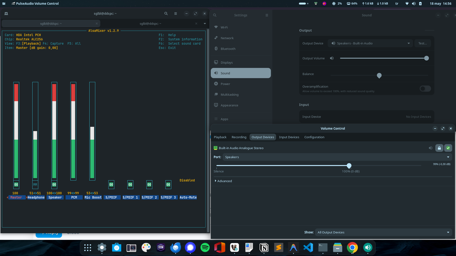

Same happened to me some days ago on my MSI Cyborg 15 A12V laptop. I also used chatgpt/gemini with 1000 commands using alsamixer, pavucontrol, speaker-test, amixer, wireplumber, arecord, pactl, lsmod, modprobe settings, speaker-test, update-initramfs... but nothing helped. I also switched between Wayland and X11 (from login screen), used older kernel (using shift button while restarting to open that screen), used oem kernel, disabled both fast boot and secure boot, even tried with live zorin/linux mint.. os usb to make sure if it's related to zorin or not. Even on live session it wasn't working so I suspect pc itself but weirdly pavucontrol and alsamixer shows everything as okay. (Note that when I connect with my headphones, they work fine. Is it the same case for you?)
