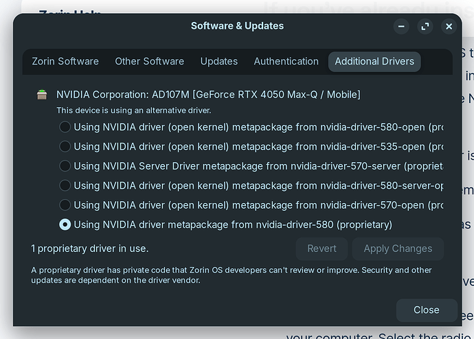

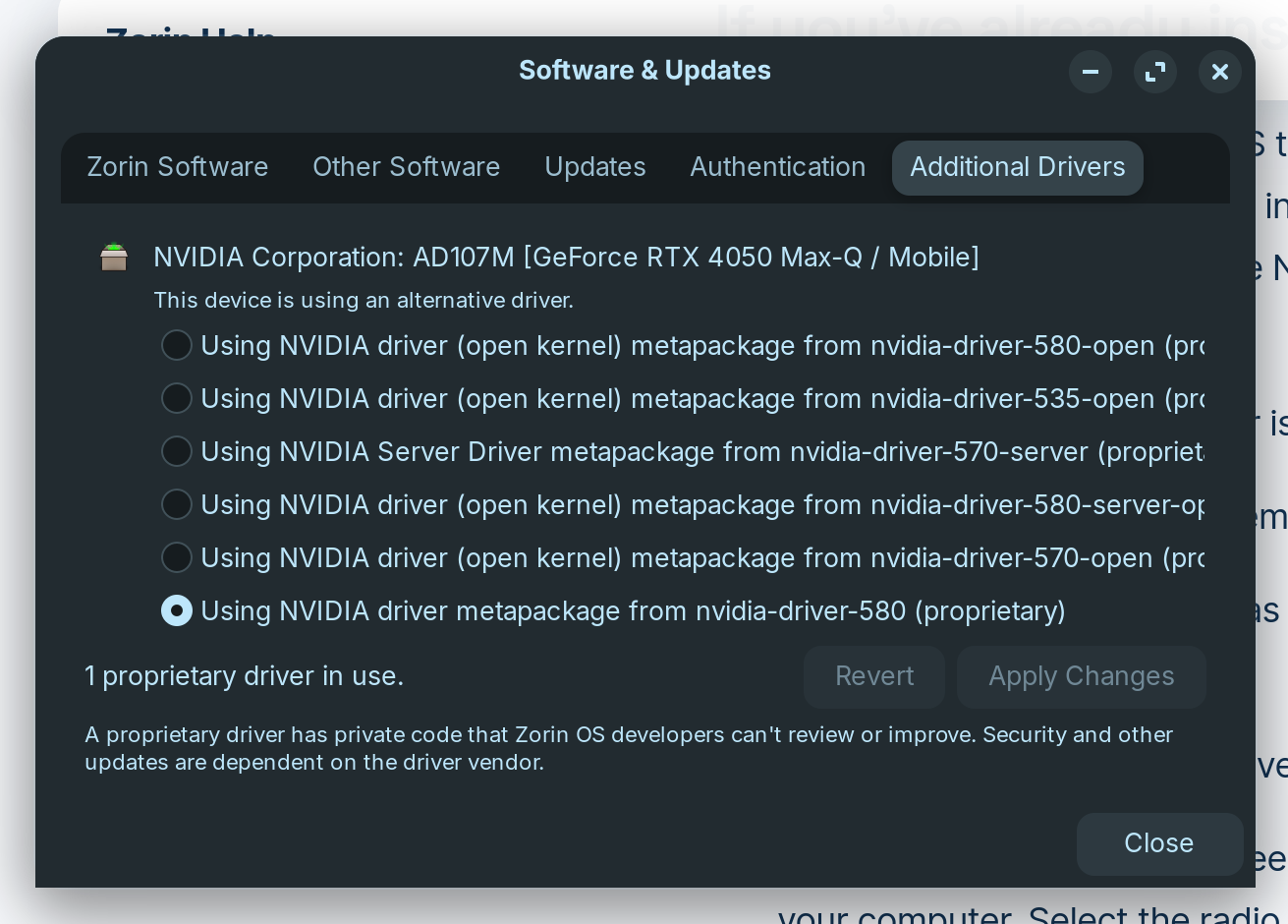

I have just turned Zorin off and on again and the audio is working as normal and now I am watching out for the trigger. I have also checked the Nvidia settings and changed them to the tested version (instead of the default one). So let's see what happens.
PS. That did not work at the audio has reverted to the initial almost inaudible issue.

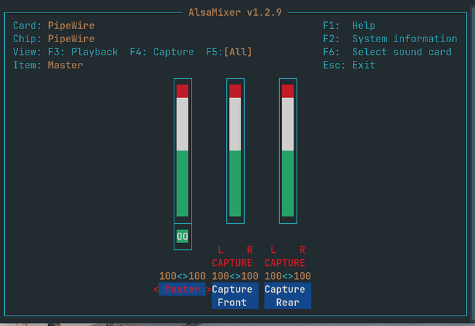

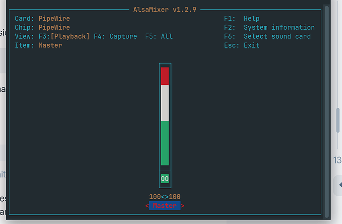

Can you open a terminal session and type:
alsamixer
Post a screenshot and that may reveal something to us.
