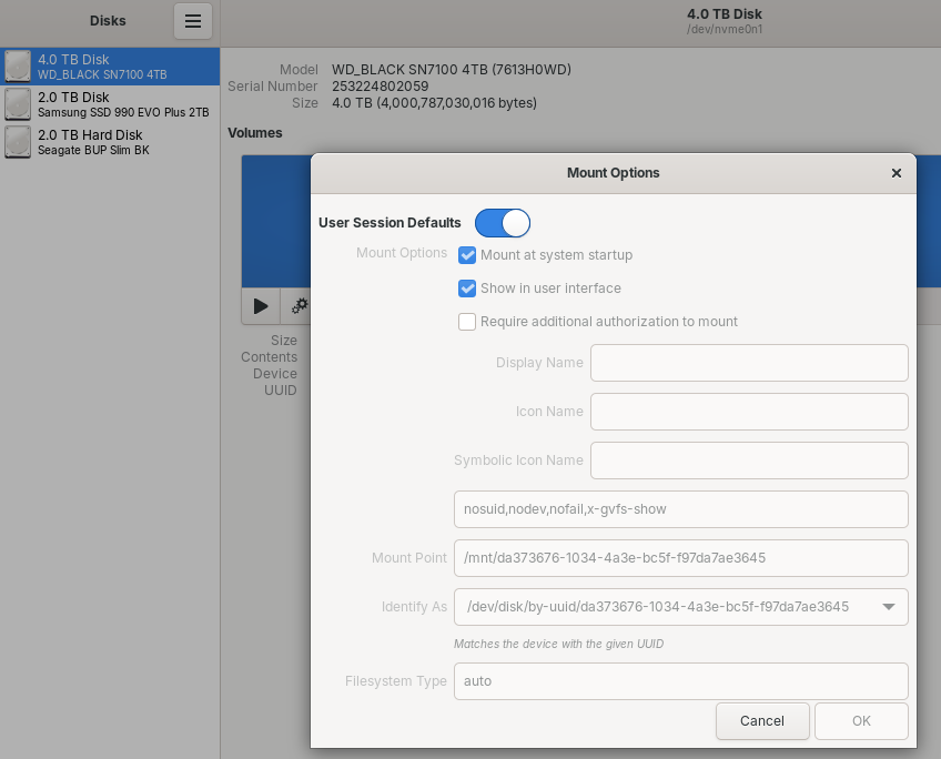

Here is my drive properties. I would like to mount this automatically upon startup.
I named the volume "Media" and it mounted under my Home folder. I didn't see any options to choose another location. Does it matter where it's mounted?
Keep "mount at system startup" and "show in user interface" enabled. Did you reboot after doing this?
Can you please take a screenshot of your mount options? What happens when you use the automatically filled out settings?

For simplicity, I'd recommend leaving the defaults as they are unless you have a reason to change them. However, you can change them in the "Mount Point" field as per your screenshot above to another location that you'd like. Keep in mind that this location needs to be a folder that already exists.

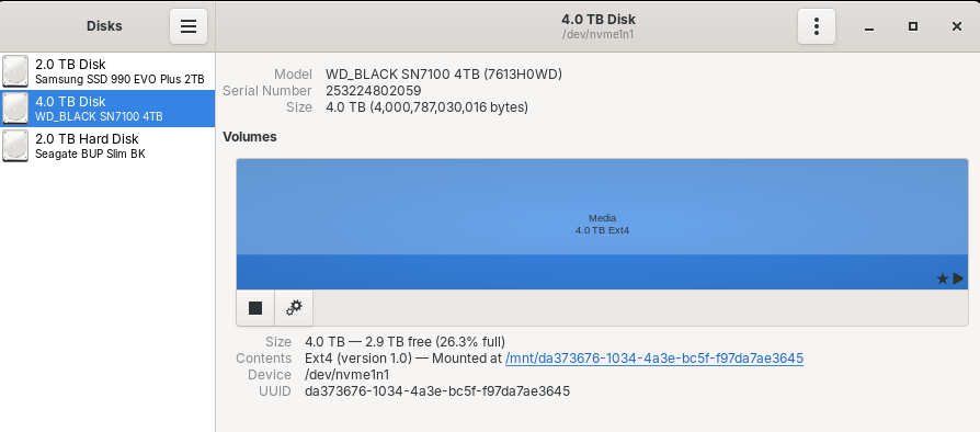

According to the screenshot shown above, the drive should be mounted at /mnt, not in your home directory. This is normal and expected. The long random string is the identifier for that drive. Regardless of where it's mounted, it should show up on the sidebar, is that not the case?
Ok, I stand corrected. It did work however it mounted it in the /mnt folder, which it exactly where the dialog says it would be and named it that long string identifier. I was looking for it elsewhere. I have a /media folder now as well with a subfolder of my username with nothing in it. I assume this was a result of something I did.

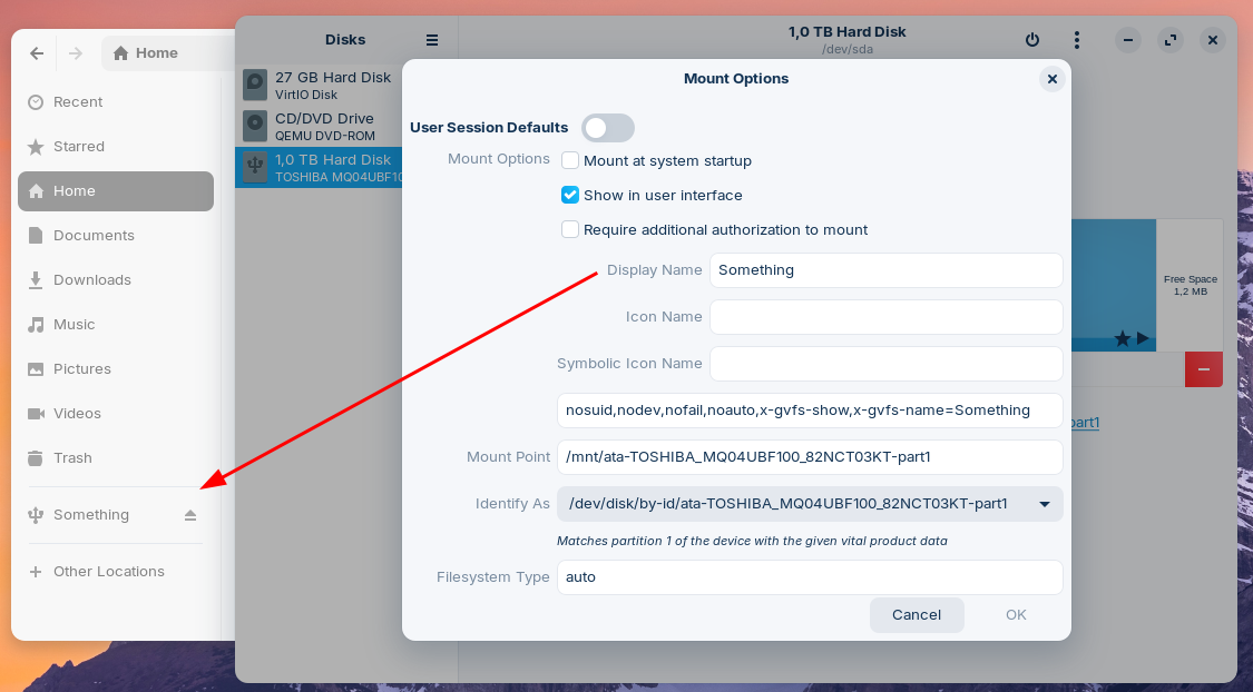

You can't change the identifier itself, but that is mostly used for system utilities and whatnot, and you can give it a name that will be displayed in the file system:
Notice that, even though the actual mount point remains /mnt in this example, the displayed name updates accordingly.

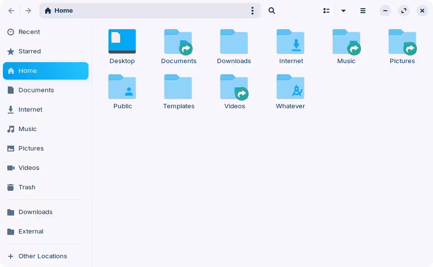

Here I've updated the configuration file to point the "Downloads" and "Template" folders to "Internet" and "Whatever", respectively. After reboot, notice the second screenshot that the folder icons have automatically updated, and also the sidebar.
It doesn't show here but the behavior of Template is now also updated when creating new files. In fact, since it's empty, I can't do right-click → New File, until I put some files in there to use as base templates.
I tested it (only changing the path for pictures) with a new created folder in my home directory in which I put a childfolder pictures and it worked, also after reboot.
