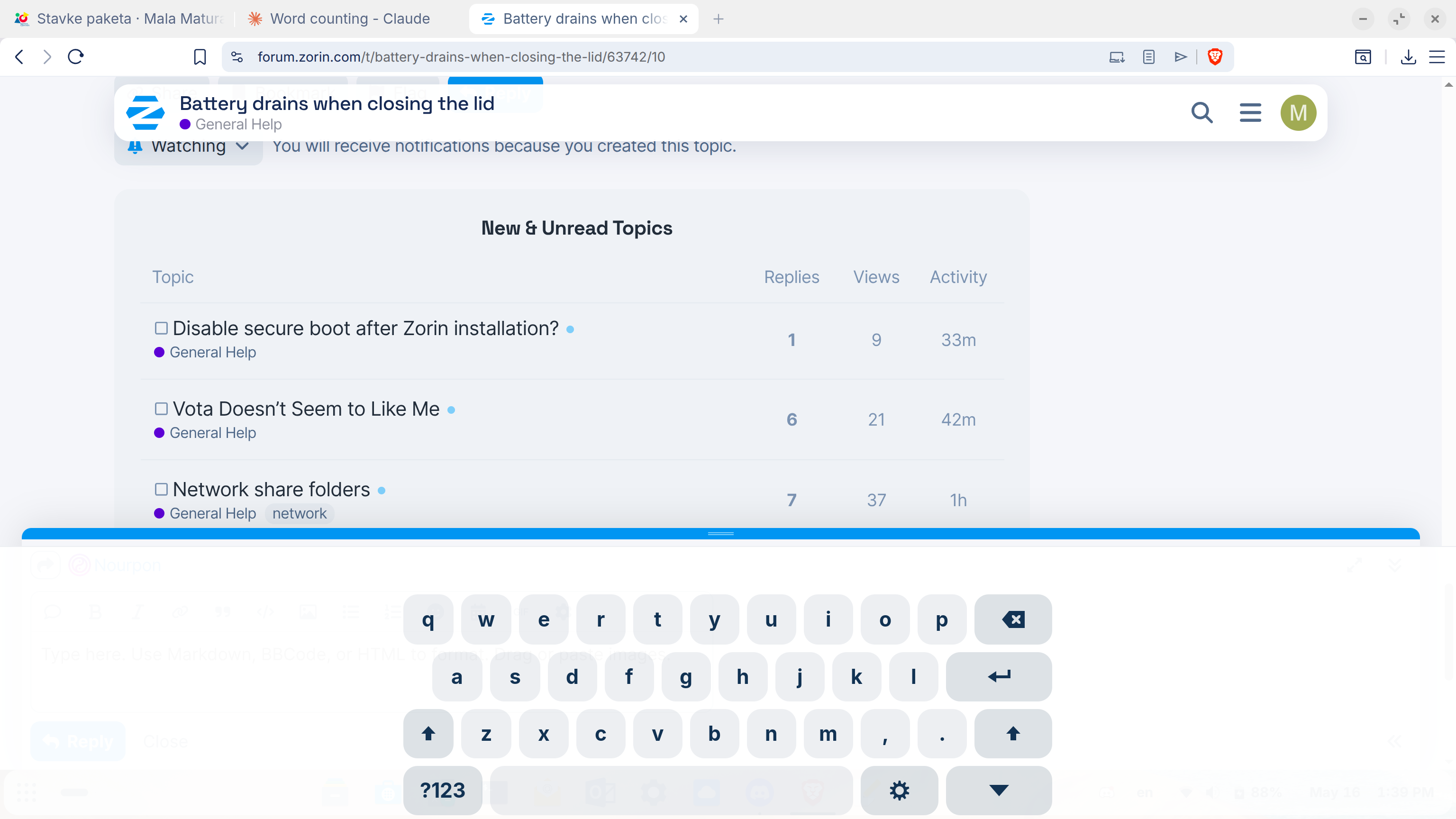

I'm still testing. But I can see that xorg switch probably activated this gnome keyboard popup all the time. I checked my settings and it is disabled, but why it pops up, I have no idea. And it seems I lost the ability to drag and drop my files/icons from desktop to ChatGPT directly through the dashboard. It used to work with wayland.

you can also get ride of the visual keyboard, you have to disable Zorin Screen Keyboard Panel Button extension.
if you don't have extension manager installe go in Softwares and install it
