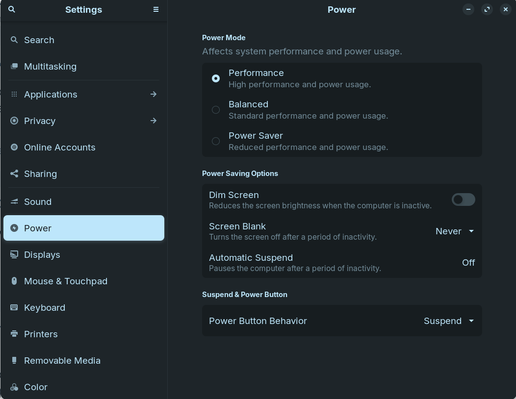

Hmm ... when You go to Settings>Power what do You see there?
You can try also to remove your battery when laptop is power off, unplug power supply, stay press 30 seconds on power button without plugin to power, plug the battery again and restart.
If it's a non easy removable battery, you will have to use your screwdriver and be really careful and does the same with the power button.
Here's a screenshot.

Could You switch to Balanced or Power Saver to check if it comes back?
