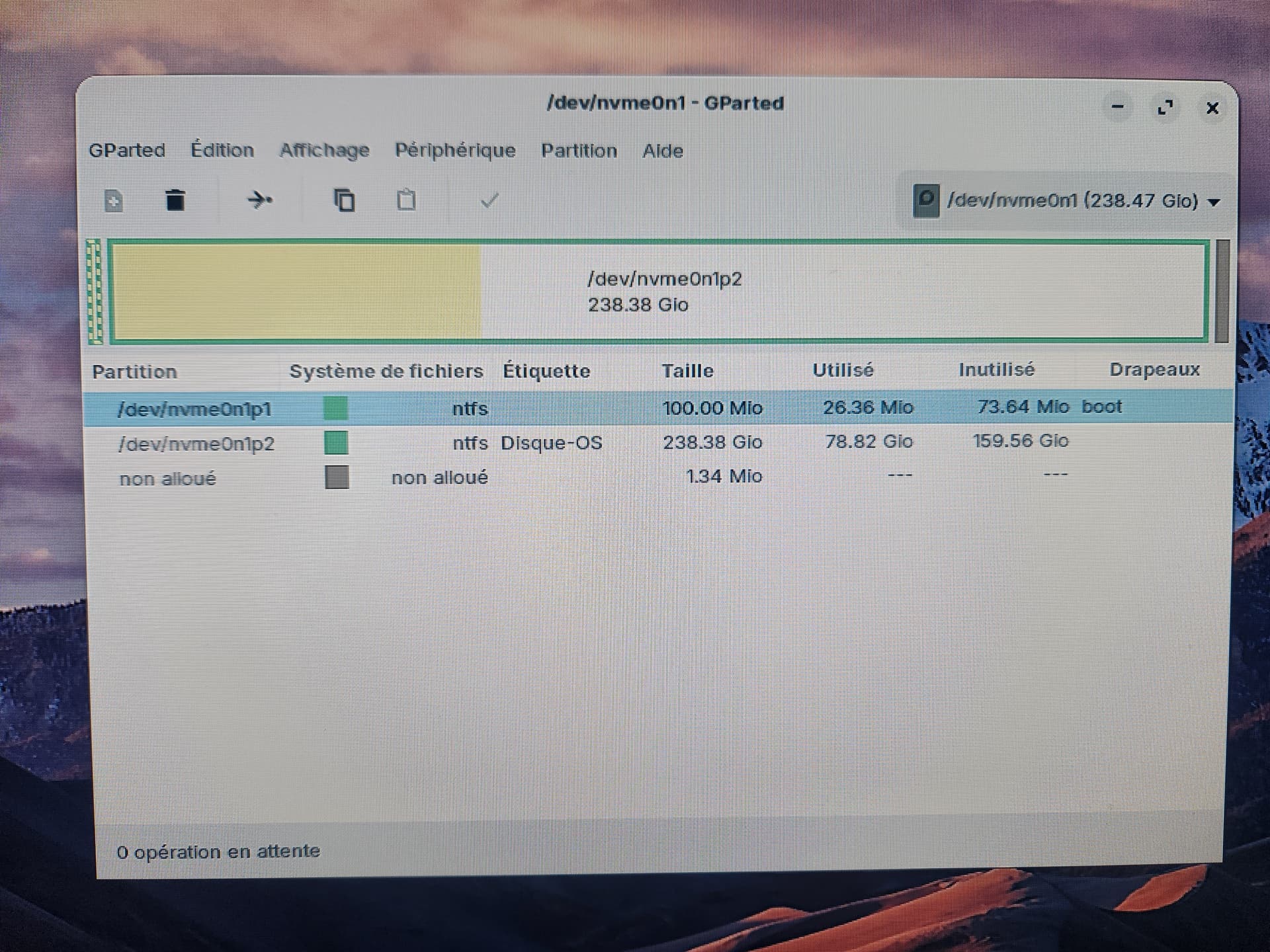

Could You start the Zorin Bootstick and run it in Live Mode please? Choose instead of ''Install Zorin'' the Option ''Try Zorin'' to do that. In Live Mode look for GParted and start it. and make some Screenshots/Pictures of the Partitions and then post it here. That could be helpful.
OK, looking at that screenshot you only have the one drive, yes? You need to use Windows Disk Management to shrink the drive - you may need to run chkdsk first.
If no issues, use Disk Management to shrink C:\ partition where Windows resides.
As Windows uses UEFi you need to use GPT setting in Rufus when creating bootable Zorin media.
