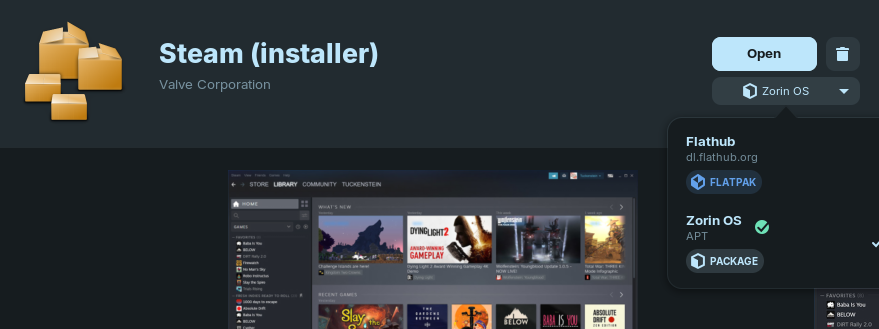

Regarding the installed Steam: I went to "Software," typed "Steam" into the search bar, and then selected ZorinOS—see the attached image
well as pretaing to steam it best to install it from this link. should be a debian or .deb all you have to do to install is click the file and it will guide you through the rest.. as for the monitor issue ill have to have someone with more knowledge help you in that area
but uninstall the one you have tho the flatpack

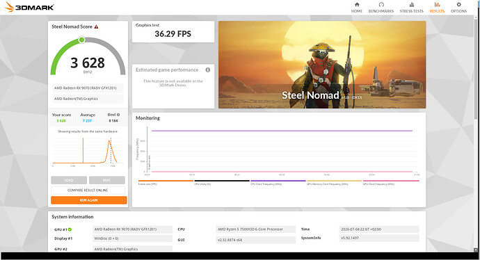

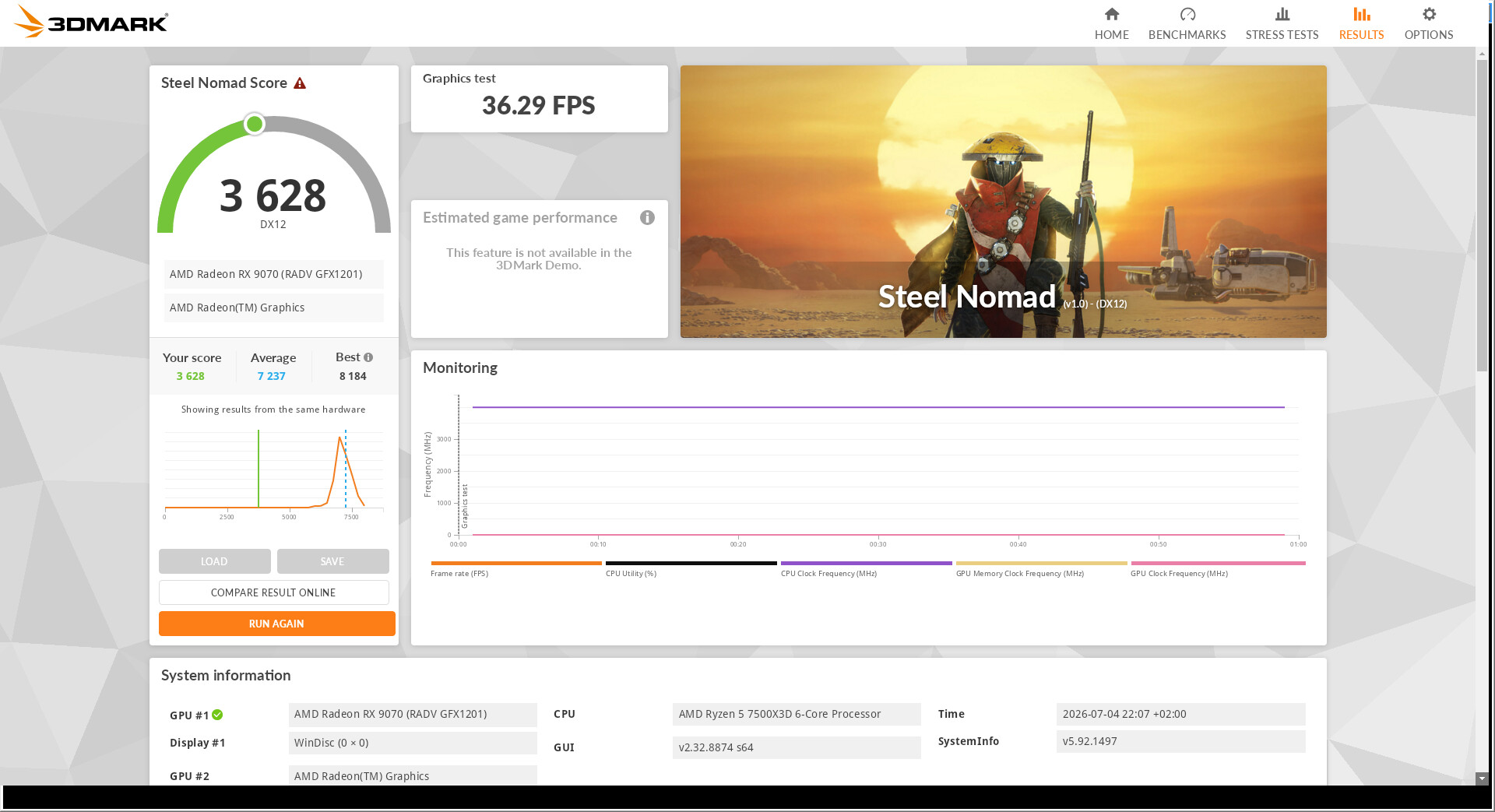

Do I need to manually install drivers for my AMD graphics card, or does Linux keep everything up to date automatically? I ran a benchmark using the 3DMark demo, and the result is below average (see attached image). Any idea what might be causing this? I've set the Power Mode to "Performance" in Zorin.
the amd drivers are built into the kernel and are updated as those come out

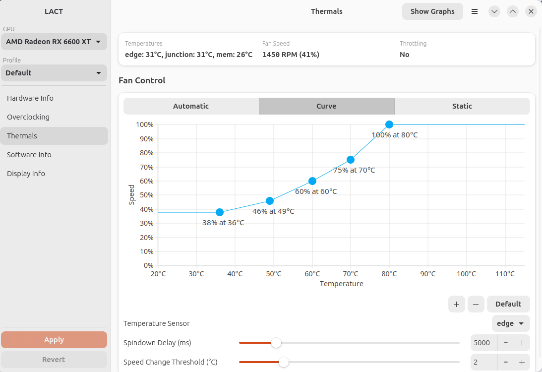

is your vid card getting hot durning the game? ah might be same problem i had with mine in the software store is an app called LACT install that then goto overclock area and enable it. you will have to restart computer for it to work then open the thermals area and setup a fan curve. then apply it on left side and run test again and see if it improves. it may ask permission to run at startup agree so it starts up at startup and now the fans should run on the card at whatever spin% you set in the curve and stay cooler and not throttle I set my minimum fan speed to 40% @ 35c heres what i set
hotest the card has gotten is 50C when palying games used to get so hot you could cook an egg on it
The Drivers are in the Kernel. So, You don't have to install additional Drivers. Theoretically, You could but maybe You could try first install a newer Kernel. That could offer better Hardware support.
You could take the Liquorix Kernel. But before You install it, make sure that in Your BIOS Secure Boot is disabled because the Kernel only works with disabled Secure Boot. How to install the Kernel:

What @Ponce-De-Leon suggests for the kernel is worth trying.. I do have that installed not only on zorin but on ubuntu 26.04 is preformance and optimized for gamers. still you should tryout the LACT app which will help with gpu temps massivly as the RX 9070 is a zero spin fan type and its spinup is to slow to control temps properly
