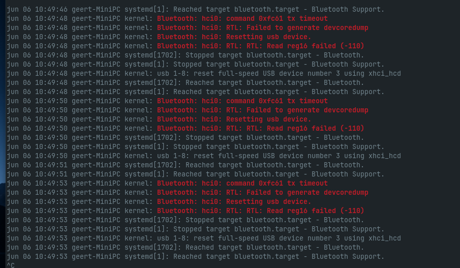

Are any errors logging? While watching it flicker on and off, open a terminal to one side and run:
journalctl -f

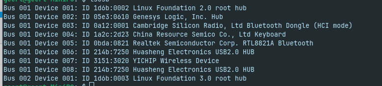

If you can Identify the card:
lsusb -nnk
in case this is a firmware issue.
Yep, there it is.
You can see that it is timing out and resetting.
This means that the software, audio, bluetooth etc are not the issue.
The kernel is requesting the hardware, and it is crashing, over and over.
This looks like a kernel regression for realtek, to me.

Device 3:
ID 0a12:0001 Cambridge Silicon Radio, Ltd Bluetooth Dongle (HCI mode)
