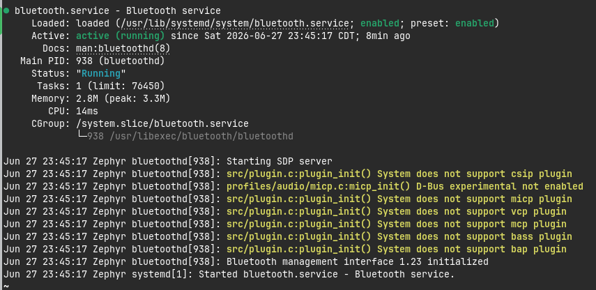

systemctl status bluetooth

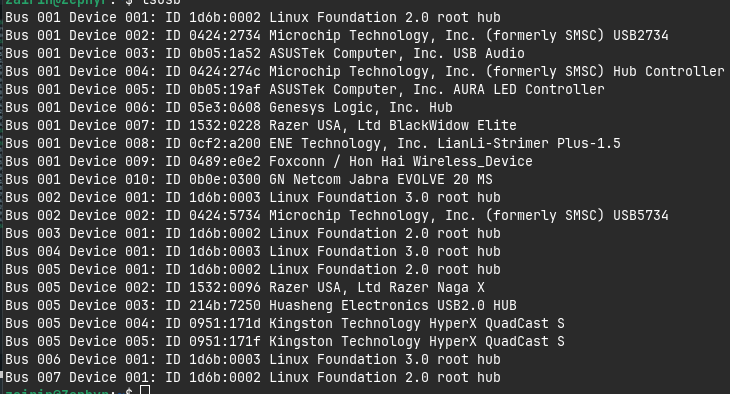

lsusb
bluetoothctl list
Nothing returned.

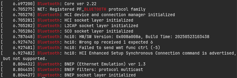

sudo dmesg | grep -i bluetooth

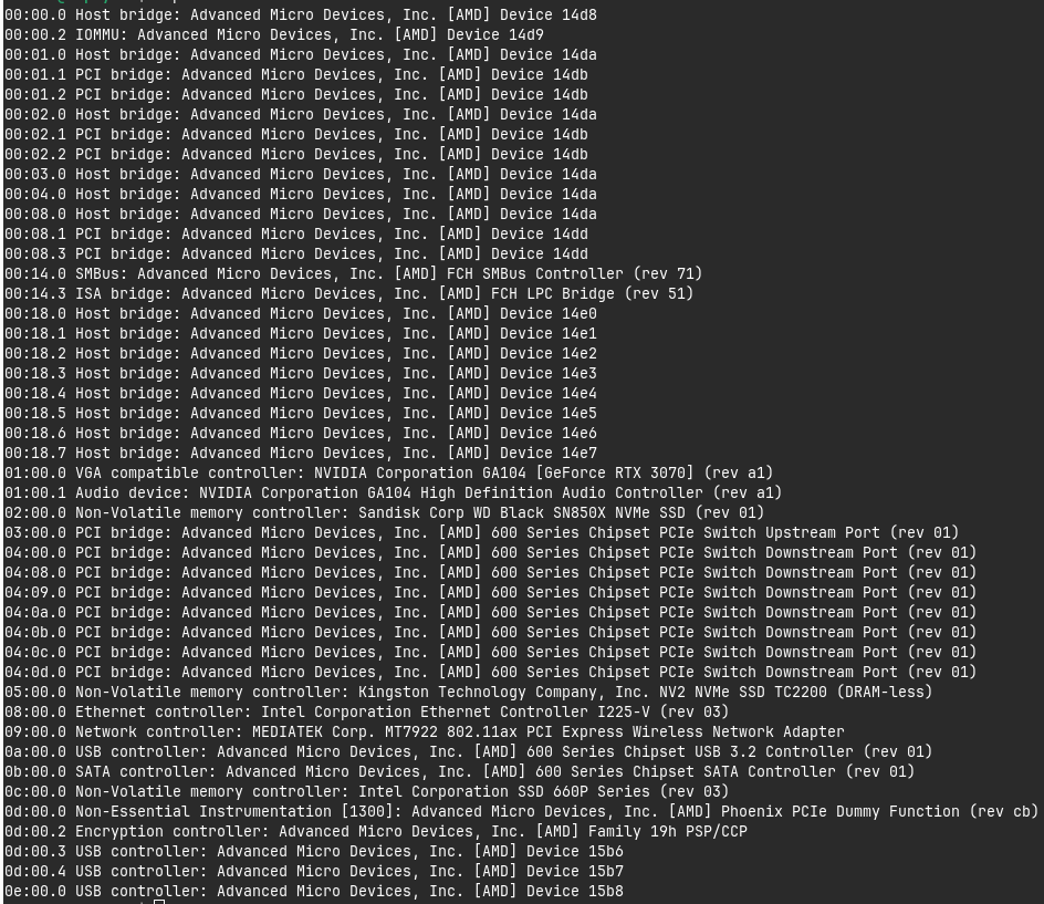

lspci

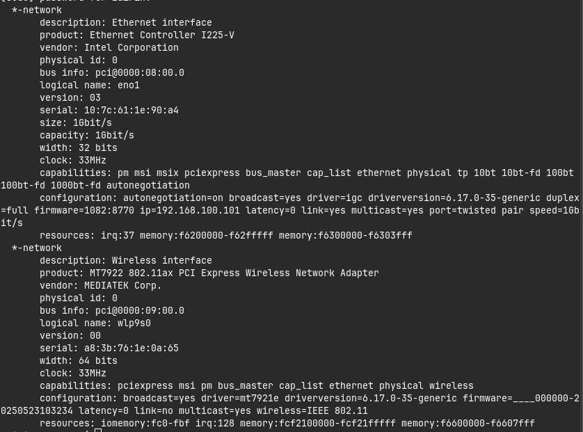

sudo lshw -C network

Maybe try restart the Bluetooth Service with
sudo systemctl restart Bluetooth
Check the service command first: on Ubuntu/Zorin the unit name is lowercase, so use sudo systemctl restart bluetooth and then systemctl status bluetooth --no-pager.
If it still flips off immediately, I’d do a full cold boot next: shut down, switch off PSU/unplug for 30 seconds, then boot and check rfkill list again. Built-in BT on motherboards is often behind an internal USB device, and suspend can leave that controller in a bad state until power is fully removed.

I did try the restart Bluetooth command Ponce-De-Leon and LucasZorinNL mentioned. I did check the bluetooth status afterwards, but not with the --no-pager addition. It wasn't really of much help. I did also try rfkill list.
