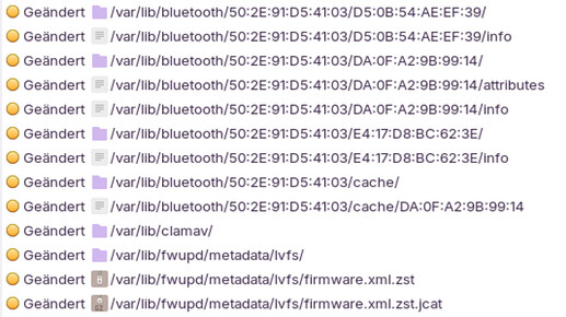

Even it was not clever to do that, I tried to install a Beta app TMOG (.deb) and the installation itself hang. I went directly back to the system state with the timeshift snap which was just one hour ago before this victim app installation.
Have the timeshift LOG File about the recovery yesterday. Here parts with bluetooth and firmware mentioned:
