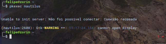

failed to put this command does not open
unable to connect
I tried to open nautilus as admin and I didn't find this folder
I don't know what happened to keep showing this message when I boot the system
