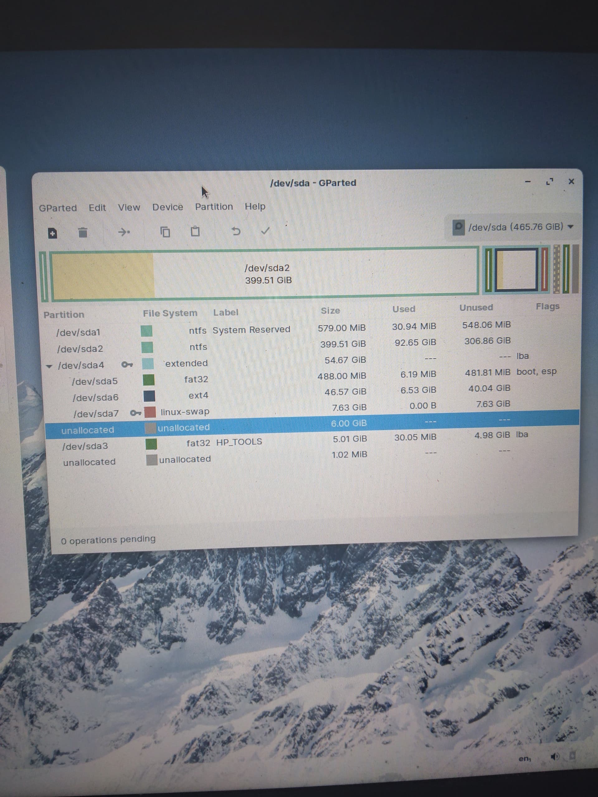

u might have installed zorin os incorrectly. boot from zorin os live and open disks or g-parted and show us the screenshot of your partions
Here is the screnshot of partitions
When i ran boot repair it gives me set your bios in legacy mode then type sudo update grup to add windows entry to your grab menu, but bios is already in legacy i think, its in "legacy support enabled secure boot disabled" option.

The Screenshot you shared above for your Gparted screen is very tiny and impossible to read.

The image is very small. I believe the only way to view it at proper size is for the viewer to register and make an account with that website.
sda5 looks like the EFI boot partition - formatted to FAT32 with 488megs in size.
If Windows is booting in Legacy, then that EFI partition is likely created for Zorin OS.
If you burned the Zorin .iso with Rufus, I believe that Rufus only burns for EFI bootable images.
You might try booting the LiveUSB installer image on USB and in terminal running:
sudo grub-install /dev/sda6
In order to install as BIOS mode to your existing Zorin Install.
