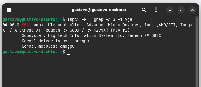

Are you on AMDGPU Or Radeon driver?
Hi, AMDGPU I guess
