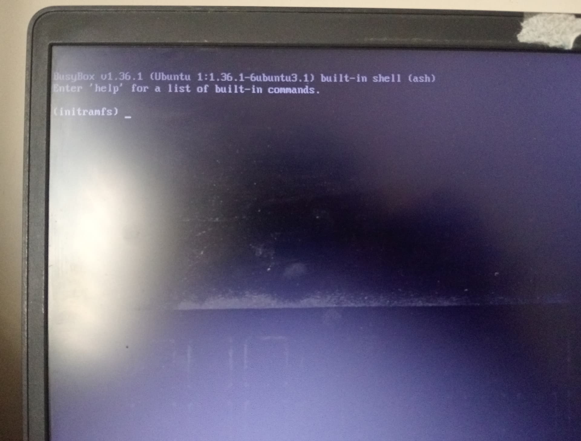

Busybox (Intramfs)
Ill let the picture speak for itself, the only things i remember doing before this happening was leaving my laptop on and i dont remember if i turned it off, but i probably didint, also i forced the laptop several times to turn off because a lot of my games crashed my entire laptop when there was vibration on them, i tried to disable that option on steam settings and in the games, but it doesent seems to be working, the only good thing here is that i have windows, the bad thing is that it doesent has dual boot, so i need to go to bios and select it, idk why, but i have it so it is something.
So yeah thats all, i will come back in some hours cuz rn im not in the moment yo use my phone (im using it rn but later i cant), so i hope someone can help, i love u all linux and zorin community

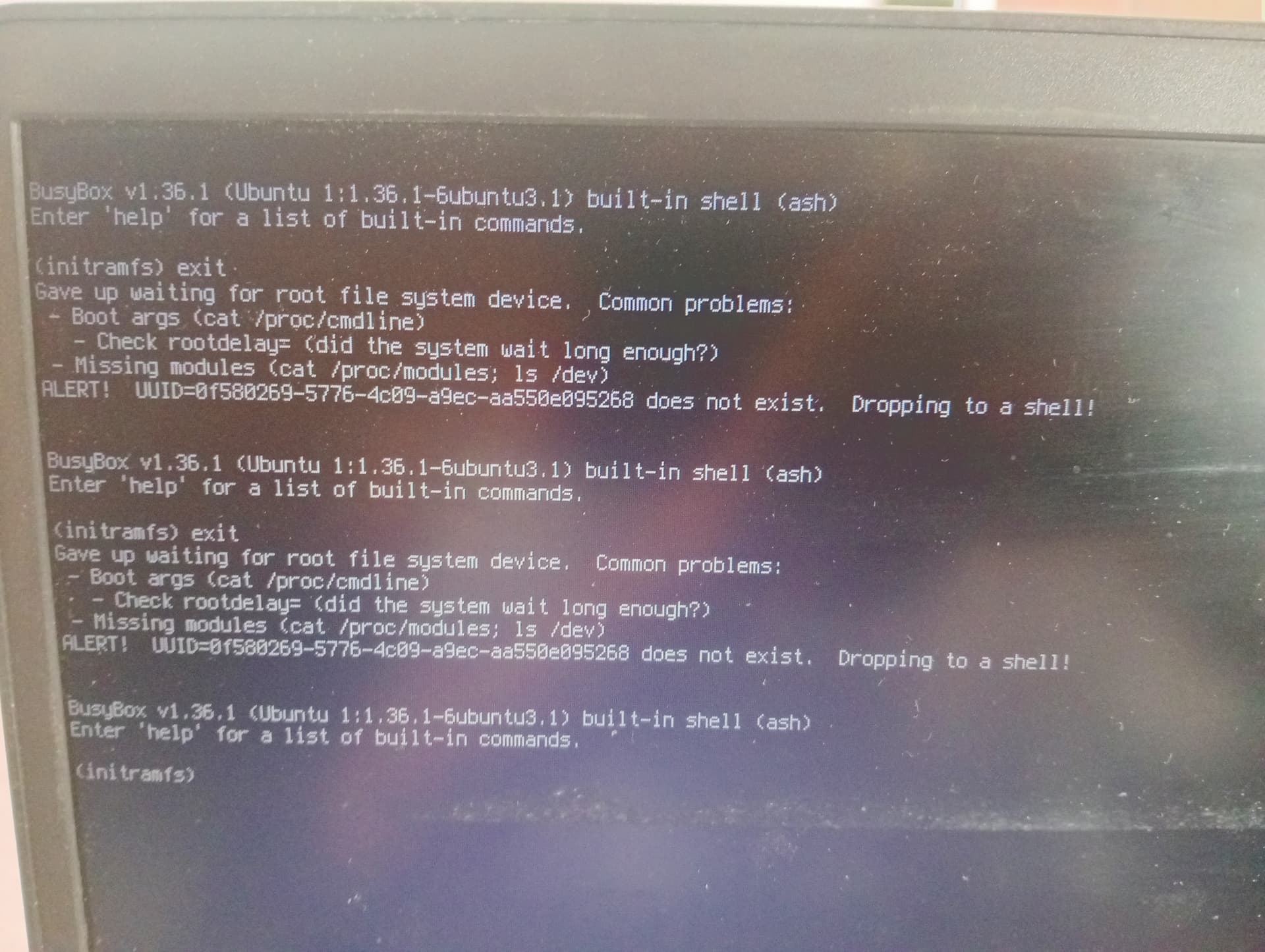

Yeah, i forgot to update that, no, sorry for that bud, im using core, also in the image i tried indeed using exit, but idk what does the thing int the text mean
Sorry, missed that.
Basically I would boot into BIOS to make sure your drive is listed. If it isn't then you may have suffered hard drive failure.
If the drive is showing up in the BIOS I would use your Zorin installation media to boot off, select 'Try Zorin' and once the desktop appears, run Boot Repair to see if it can fix your issue.
You can relay that here; a picture of the screen taken with phone camera is fine.
You probably would be best to start by running fsck (FileSystem ChecK) on the unmounted drive.
@Aravisian they already did that in the screenshot after 'exit'.
Um, how am I not seeing it? I see "Exit" twice...
I see that root has a corrupted file under proc
I do not see where the user said that they tried fsck nor is it in the screenshot.
I do recommend running fsck from LiveUSB on the unmounted drive over doing it from BusyBox....
Hi, what I (he meant) was he typed exit and got the errors reported. The first 'major' issue is it could not see the hard drive at all which is why I suggested he check it is showing in the BIOS, if it isn't then it's potential hard drive failure.

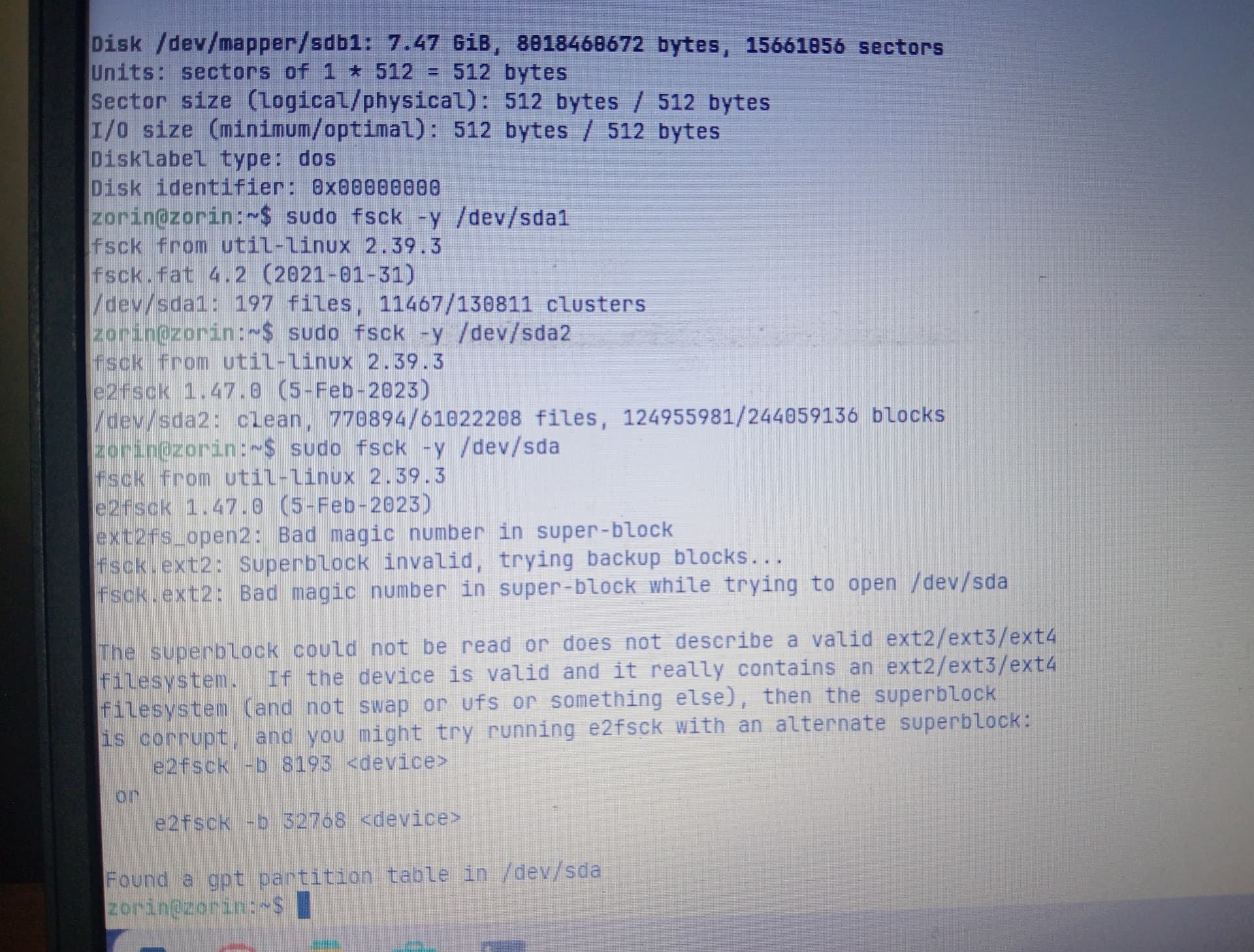

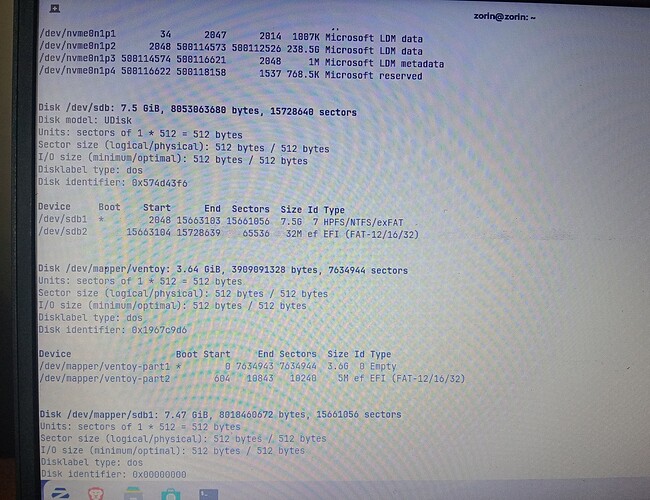

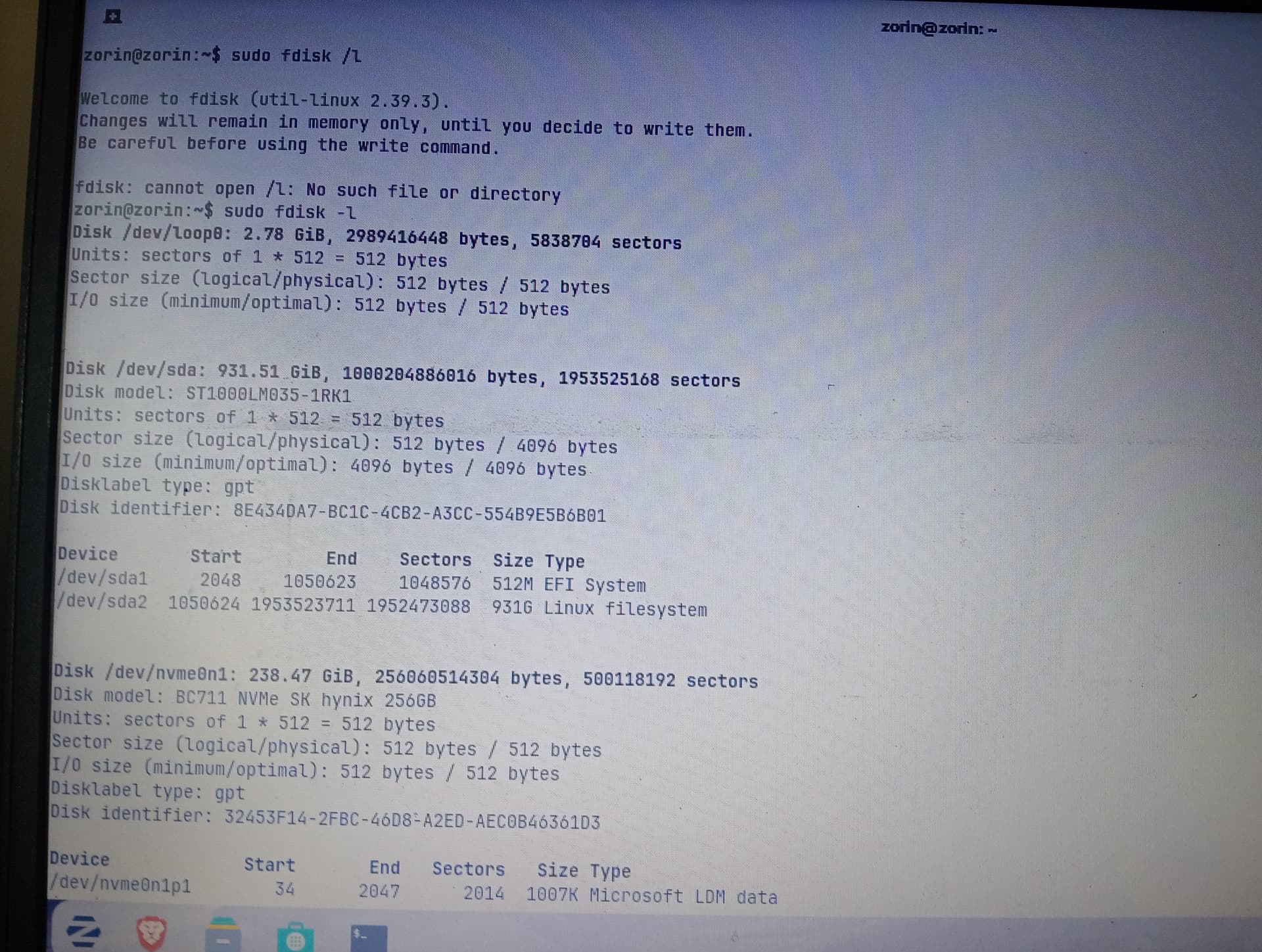

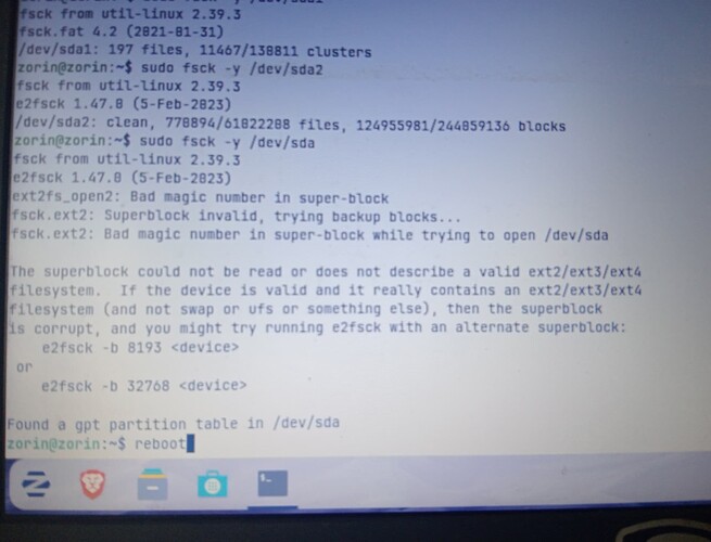

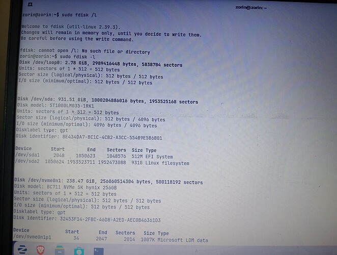

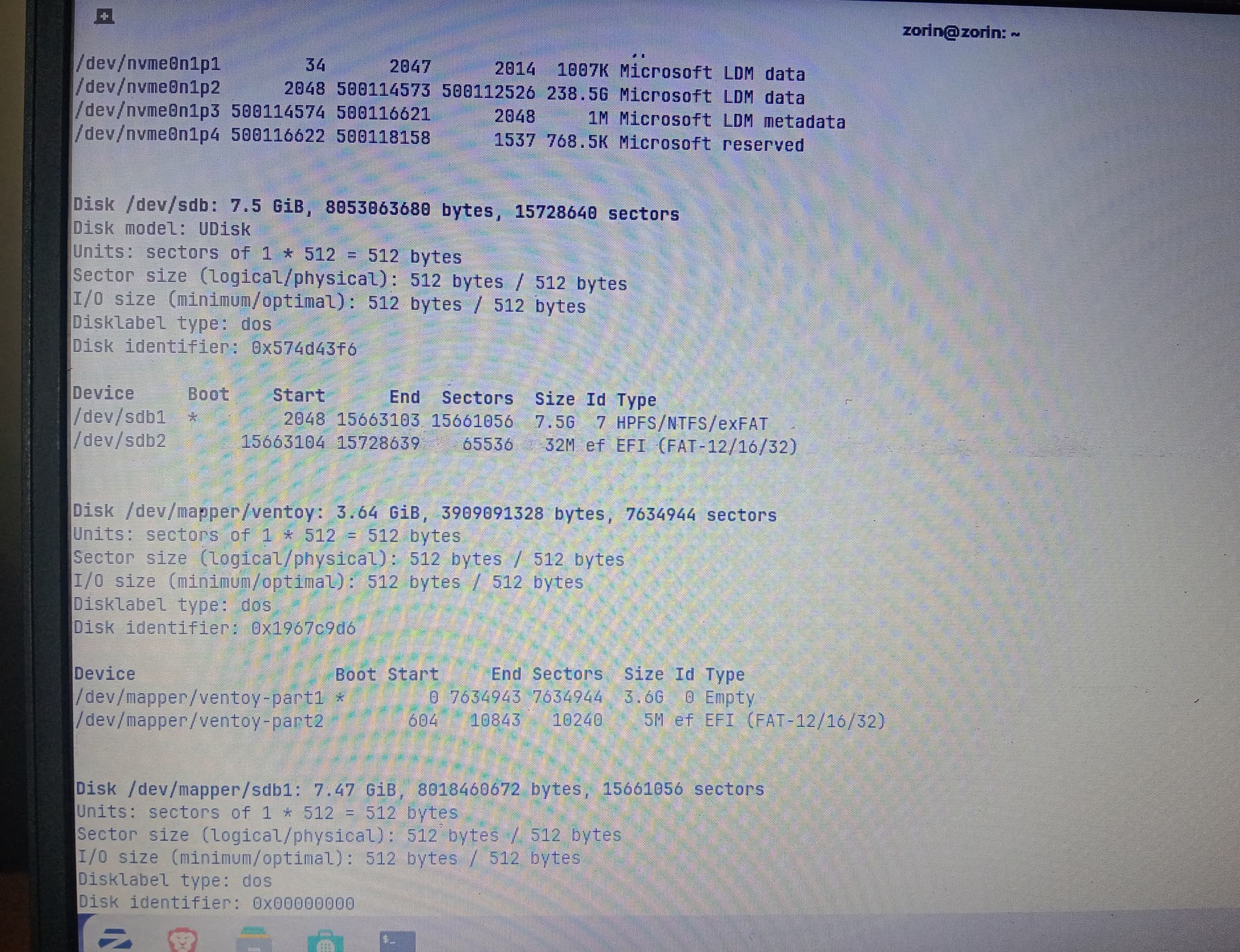

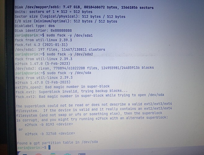

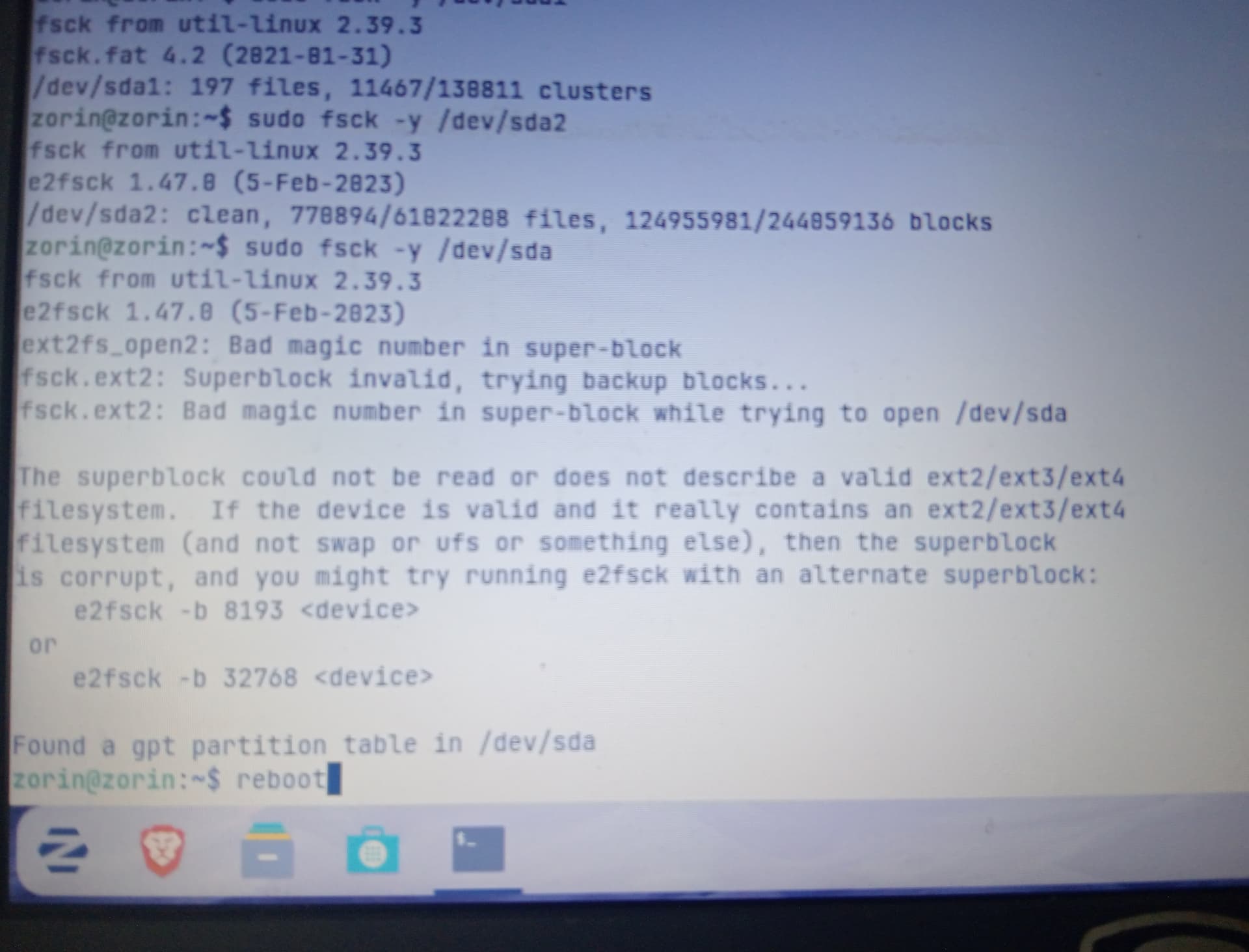

Hey, so i finally understood what i had to do, at least i read bout it, but, it didint work at all, idk if it was the tutorial or just somethin im not aware of
Heres the tutorial: https://linux-tips.us/repair-your-linux-filesystem-with-a-live-usb-or-dvd/
And here are the screenshots in order:
So, i tried to use the repair boot on the zorin liveusb, and this happened, idk what to do D:
Nevermind, i just fd up my laptop, anyway, i intalled zorin for the 5th time, i hope this time works fine
