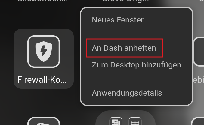

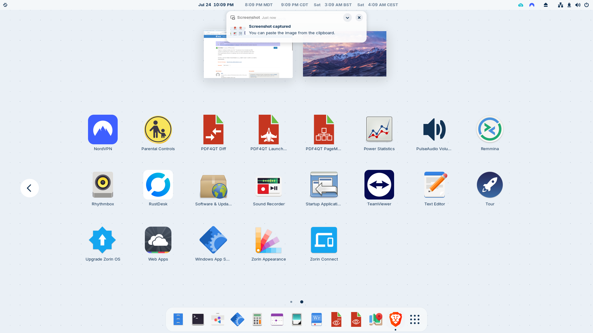

Right-click on an app in app grid overview and then select "Add to dock" (I'm not sure what the name in English is, it could also be "pin to dash"). Or you can just drag and drop apps from app grid to the dock.
The number of apps in app grid should be the same as in Zorin menu. You have arrows on the left and/or right side to show all sites of the app grid.
Edit: The last paragraph was wrong. I've never noticed that before. All apps which are pinned to the dash to dock, are no longer shown in the app grid- but in Zorin menu, they are still shown. I'm thankful, that Ponce-De-Leon corrected me.
Yes it is add to Dash or 'pin to Dash'. When you open an app, the icon appears on the Dash, while the app is open, right-click on the icon and 'pin to Dash'.
Like the Other's already said: When in the App Grid, make a Right-Click and choose ''Add To Dash'' or ''Pin To Dash''. To offer a Scrreenshot:
I hope, I understand You here right. If not, ignore my Explanation.
When You are in the App Grid and You add a Program to the Dock, the Program goes to the Dock and disappears from the App Grid. That is the Reason why it can look so limited.
I was annoyed of this and found a Gnome Extension to keep pinned Apps on the App Grid:

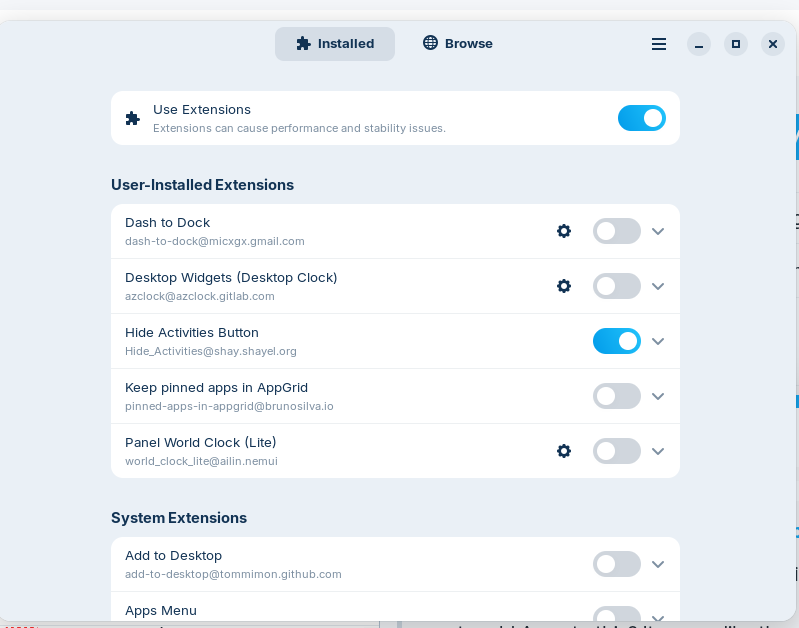

Last night I had my Dock, Desktop Wignets (Desktop Clock) Installed. Had a desktop clock and weather on my desktop. And I also installed Panel World Clock (Lite) to help with time zones. I thought would be a good idea. No problems.
When I logged in many problems. My dock started flickering. I couldn't load Brave. Had trouble. Seemed like everything was freezing, and had some pop ups that I could see through and still frozen. Best way I can explain it. Is a two-way mirror. If that helps.
I thought I read somewhere that the "Desktop Clock" and Dock had "problems". The word conky was brought up in Clock on the desktop. I went into Extension Manager. And disabled my dock. Returned my Dash Bar. Still had loading problems. Went into the Desktop Wignets "Settings" Disabled the Clock Wignet, then Weather Wignet. Then I Disabled the the Extension.
Then my loading and everything else started to clean it self up. I still have the World Panel Clock (Lite) Installed. No problems there.

No, 8 GiB are enough to run Zorin core. But some gnome extensions conflict with each other and Zorin has many preinstalled extensions. With only zorin taskbar replaced by dash to dock, I think, you shouldn't have that problems. But I've never used myself the other gnome extensions for longer.
The best is only to enable the GNOME extensions that you actually use and need. The more extensions you install, the less stable the system gets. Some make no problems, but others do.
It is a bit trial and error which ones harmonize.
Some extensions, like "Just perfection", are famous for making troubles in Zorin. Also "blur my shell" can be bad with low RAM.

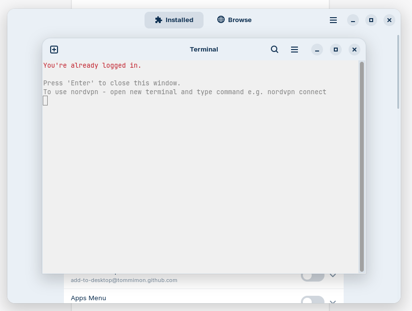

I still can't log in and connect to my VPN on the Extension. That is a whole weird thing. But I am connected on Desktop. Of course I am in Desktop Version. Still New. I have been doing some reading. Think this is called Wayland? When I was in Xorg. Everything worked better, everything. I can't even do anything there.
When Xorg works for You better, use that. That is no Issue when You do that.
Normally, Xorg. Works better. But when I am in Xorg. Nothing functions. I am barley getting by in Wayland. At least I can communicate. Somewhat.
