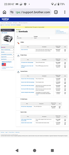

Looks like Brother provide linux drivers for this printer on their website. For Zorin, pick the .deb option.
https://www.brother.co.uk/support/mfc465cn/downloads
Though the page design is not very user-friendly, as you have to click through several steps in a tiny scrollable element at the top of the page. Though that might be due to some of my content blockers ruining the layout ¯\_(ツ)_/¯
Also as I don't have this printer I can't test the drivers.
Yes you can download the drivers from here:
You do not need the driver install tool.
Download all the 64-bit packages for the printer and scanner.

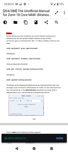

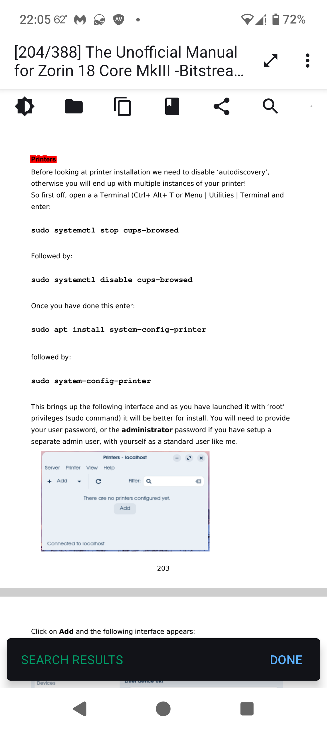

Before you install the printer driver, please be sure to follow my advice on page 203 of the Unofficial Manual for Zorin 18 Core, just the first two terminal commands relating to 'cups-browsed':

Lastly, follow my guide on how to install printers successfully, starting with the 3rd and 4th terminal commands on page 203 of the manual. The example I provided relates to Canon, but the same applies to Brother.

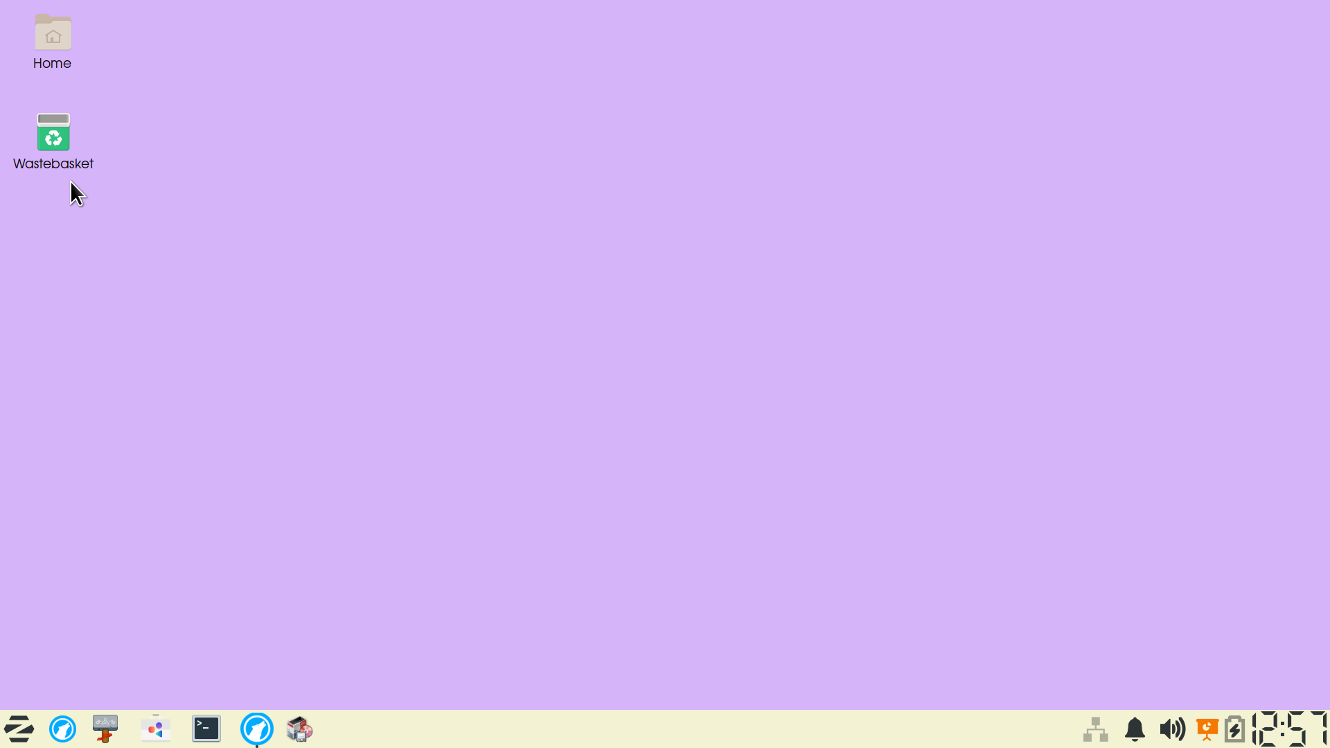

Well just installed a VM of Zorin 17.2 Lite as a VM and one of the first things I had to correct was that awful shadow font on the desktop using this code:
https://askubuntu.com/a/1329875
and so this is much more pleasant:

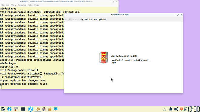

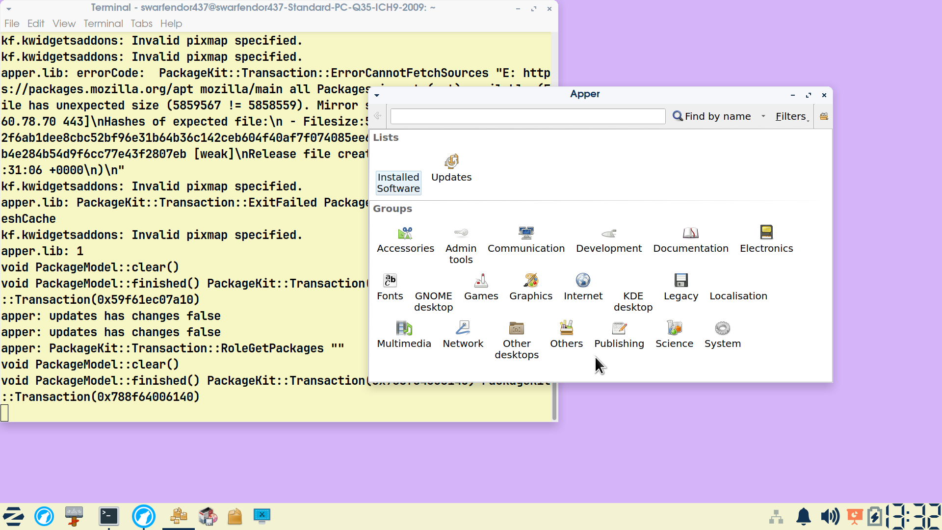

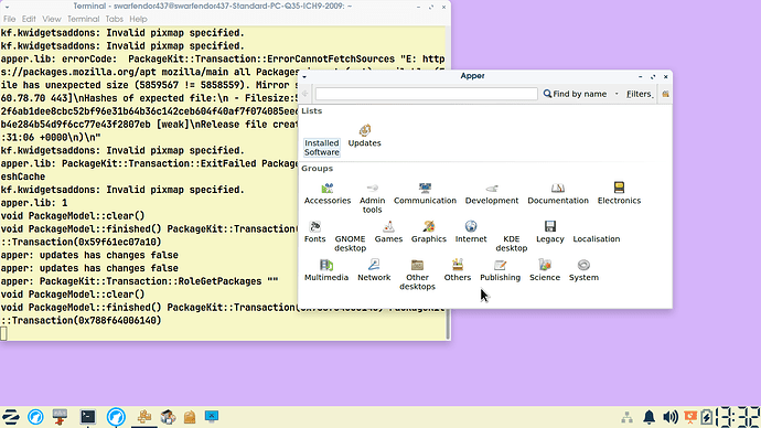

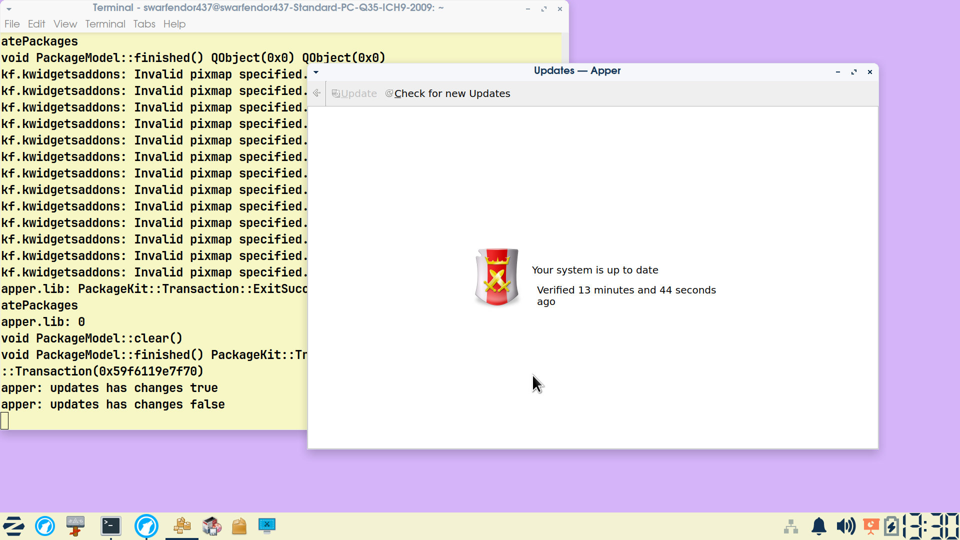

I have installed Apper, removed Gnome Software from the Panel, and Added Apper to the Panel. Was interested to see that Apper on Zorin Lite is pickingu up system updates:
Had to remove as it does not work without sudo first. So best way to launch Apper is with the command:
sudo apper

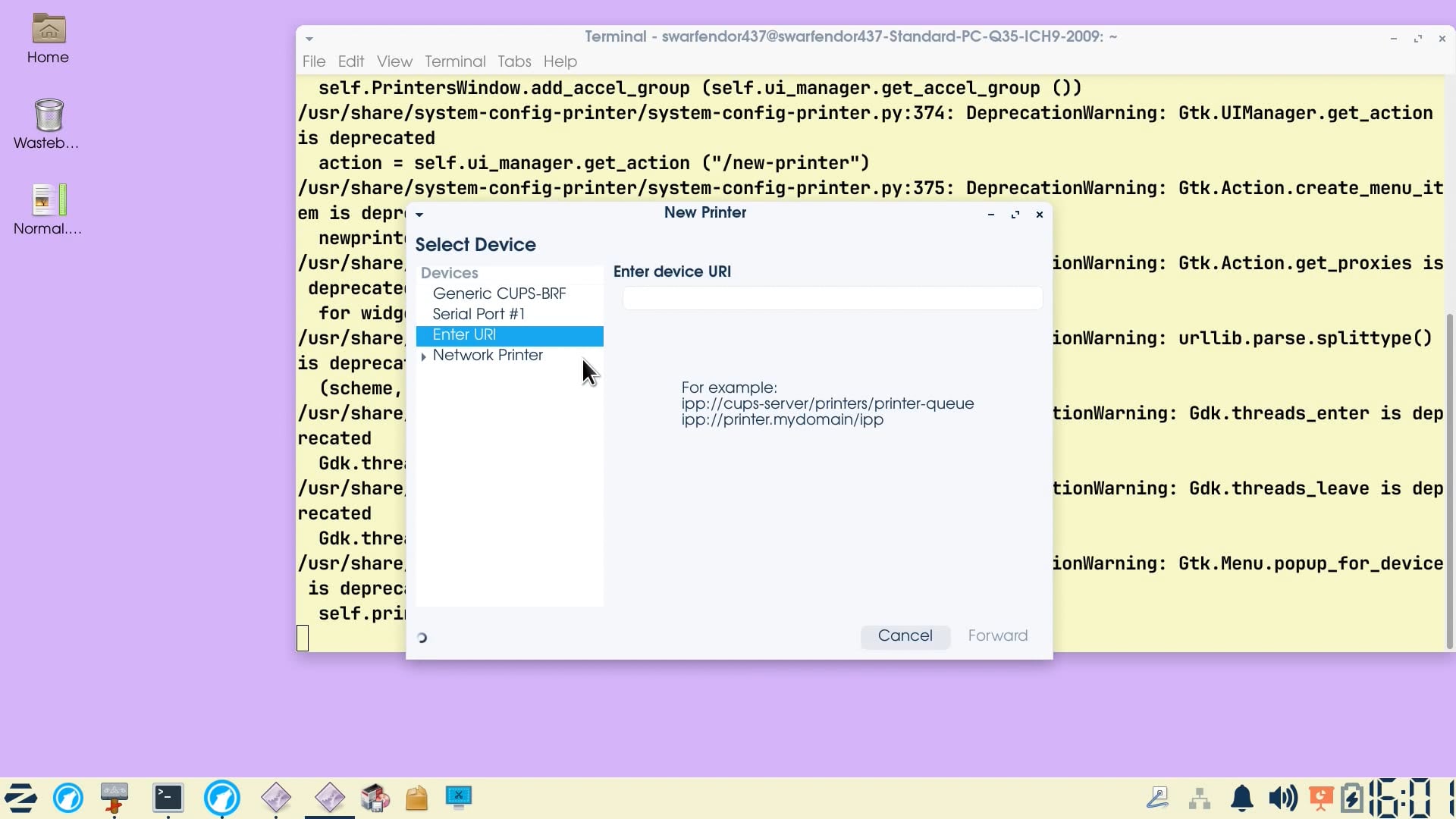

Hi, I should have explained in the description that you would need to enter your own IP address that the Printer uses if it is networked either via ethernet or via wifi.
You can safely delete that one.
Notice the network printer icon shows a printer with multiple trays - the small icon that looks just like a printer with ordinary output tray is your local printer.

as you will suffer from the cups-browsed issue. You will need to install 'system-config-printer' as for some reason, Team Zorin removed it in 18 Core.
