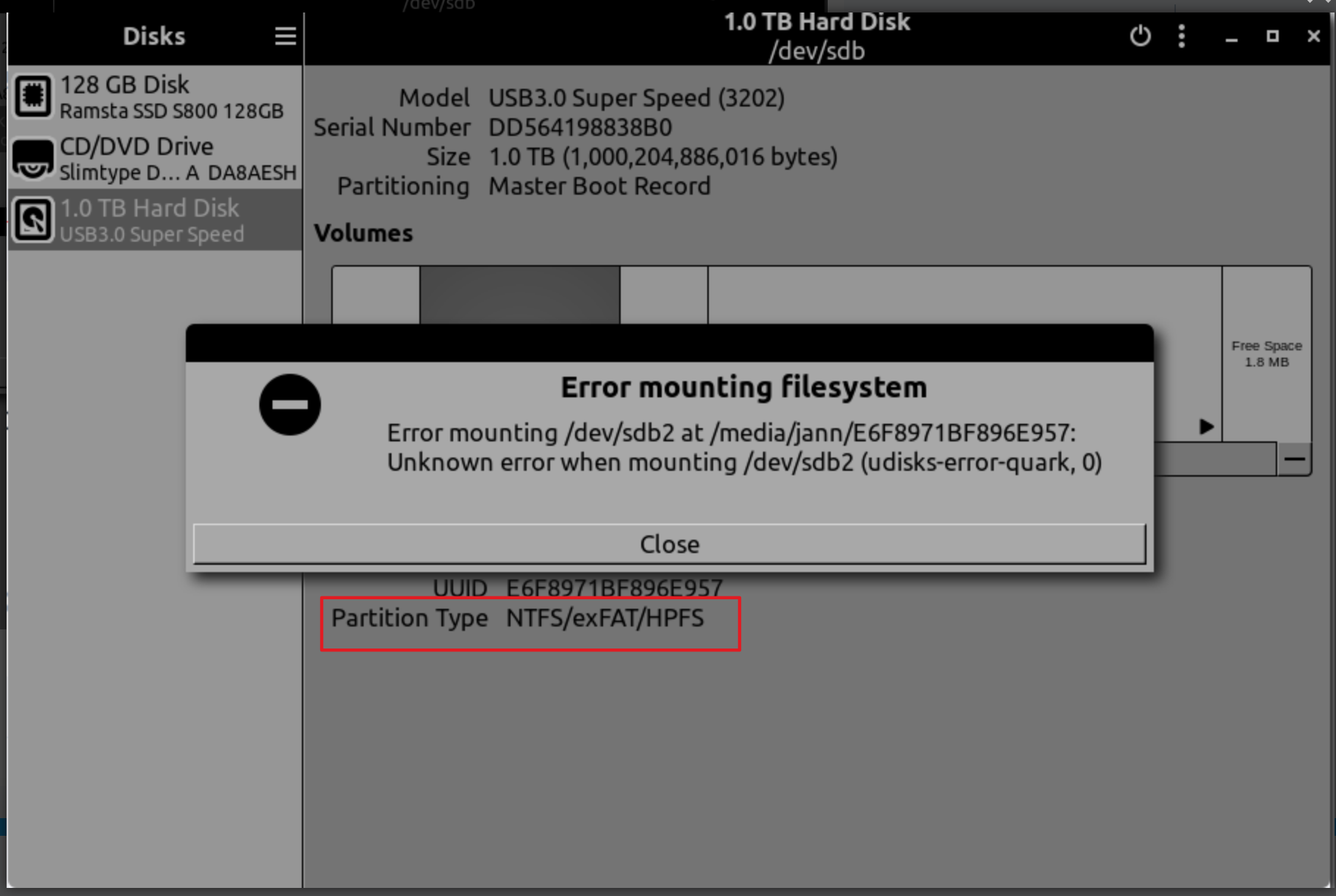

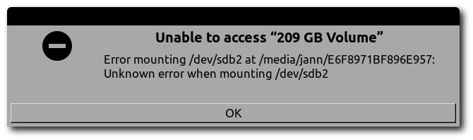

The power went out suddenly when i was in VSCode. After that, this appears when i try opening one of the partitions on my hard drive. The file that i was using was saved in that partition
I would suggest to unplug the Driver, make a Reboot and then plug it in again.
still the same
When you have connected your external drive and open the app disks, can you select the external drive and click on :play_button: to mount it?

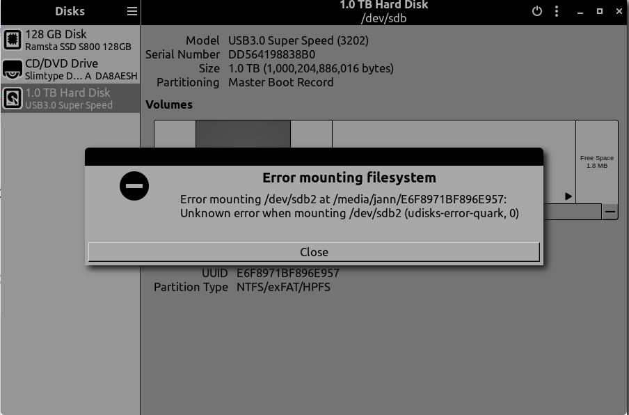

This is what it looks like
How is the external drive formatted (ntfs, ext4...)?
I am not sure why.

I can see on Your Picture that the Drive seems to have several Partitions and Formats:

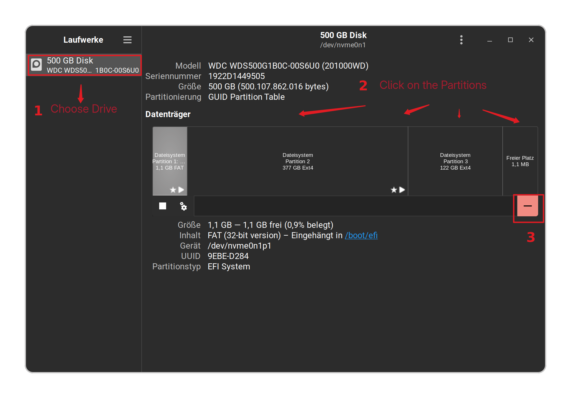

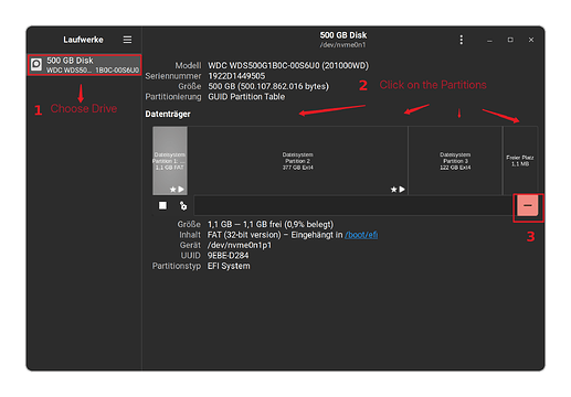

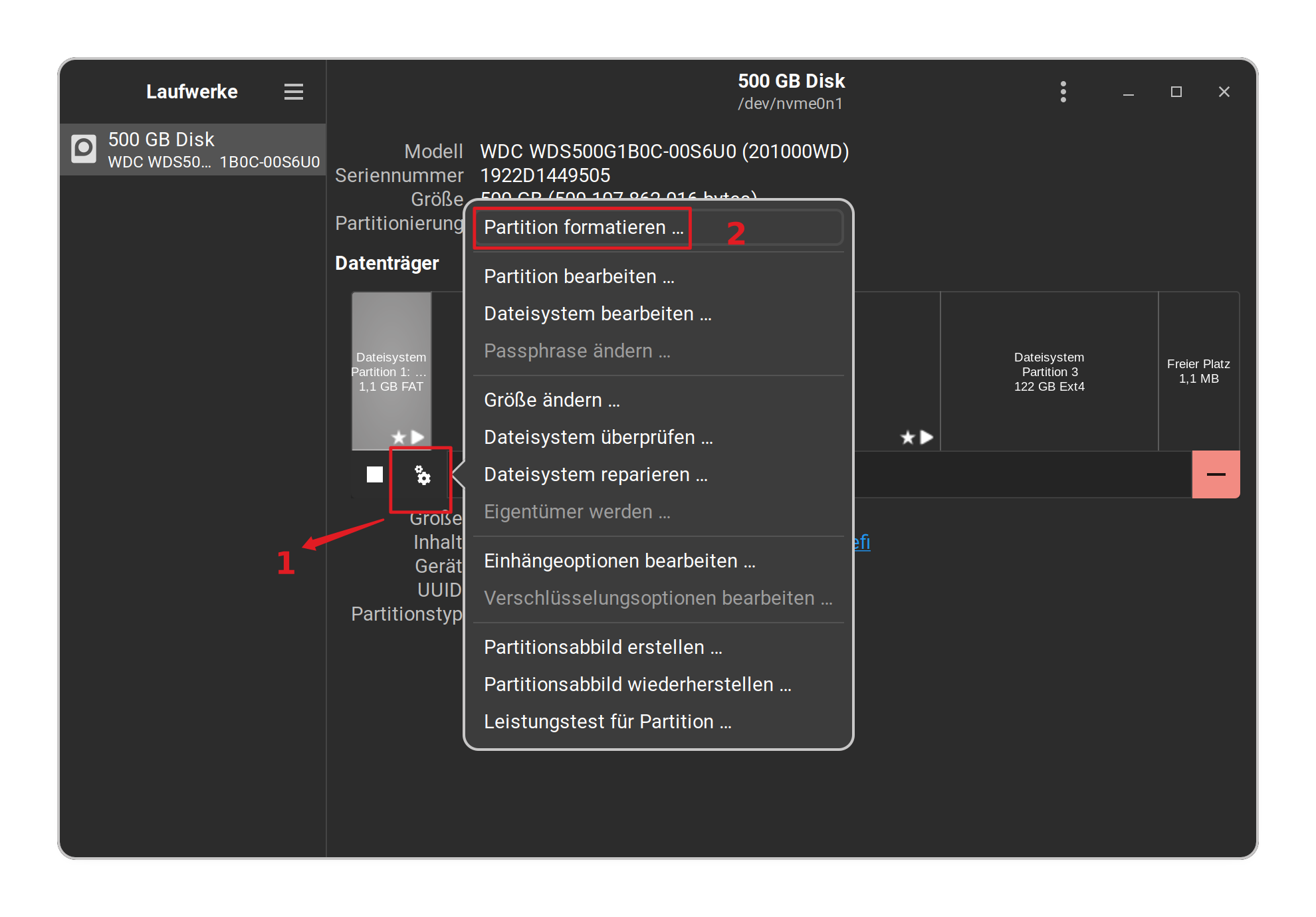

When You are in Disks, You choose the Drive on the left Side and then You click on every Partition on it and then on the - at the rights side under the Partition Table. After all is deleted, click on the Gears Icon and choose ''format Partition'':
