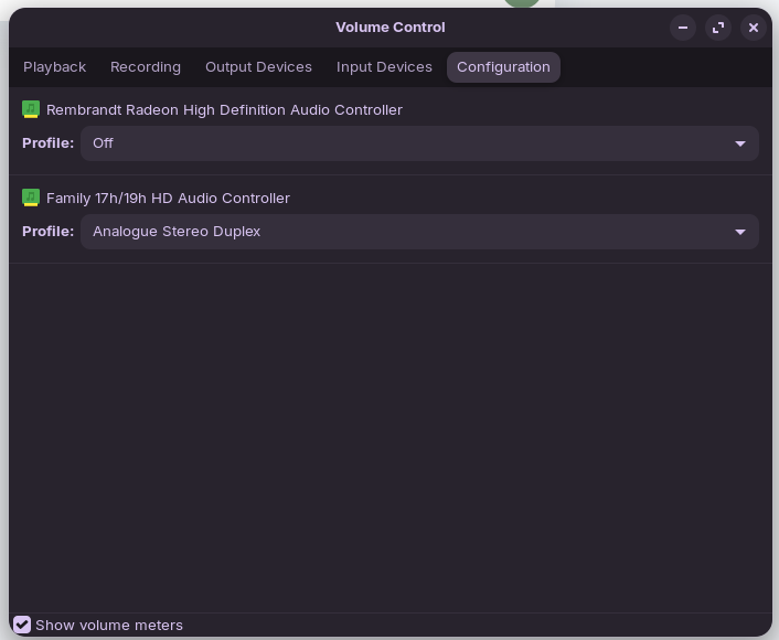

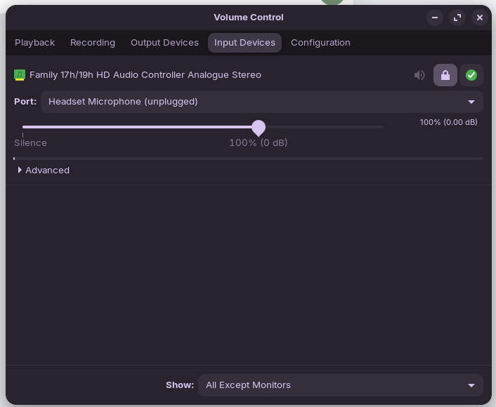

And within that menu, you can find Input devices, and there's also a tab for Configuration. Sometimes, in one of those menus, the device is simply selected wrong or configured wrong, so it's worth a simply check on that before going any further.
You could include screenshots of what you see in those menus as well, just so everyone here can see as well.
In that first tab, there's a dropdown with Headset Microphone. Is there any option in that dropdown? If there's not, in your Configuration tab dropdown for Family 17/19H, are there any other options? In my laptop (5700u amd) that's where my microphone is located. However, perhaps yours is in the dropdown for Rembrandt HD Audio Controller.

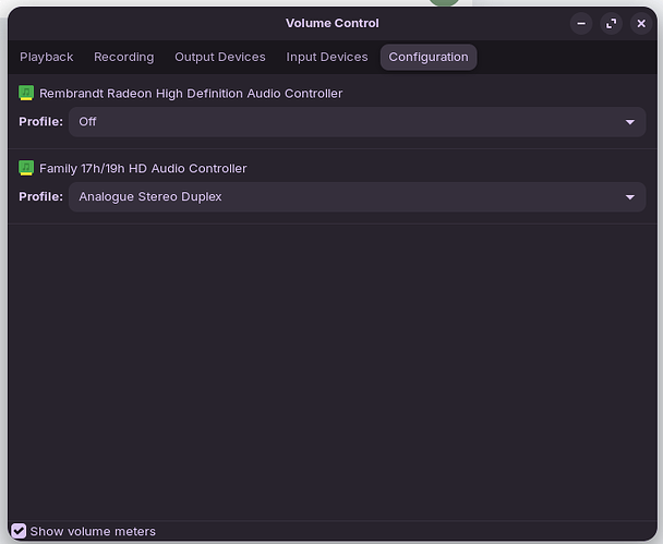

Hmm, I'm looking online and it seems some Acer models have the problem you're describing. For some, selecting the Pro Audio option in the configuration alone is enough to fix the problem. Could you try those options first and see if you get some response from it?
So in the config tab, select "pro audio" for both of the things on there?
Yes, just to see if that kicks it into gear or not. It should be mainly the the Family 17/19 dropdown we'd want to switch, but it doesn't hurt to try both. Can always change back easily if wanted.
Tried it and it did nothing.

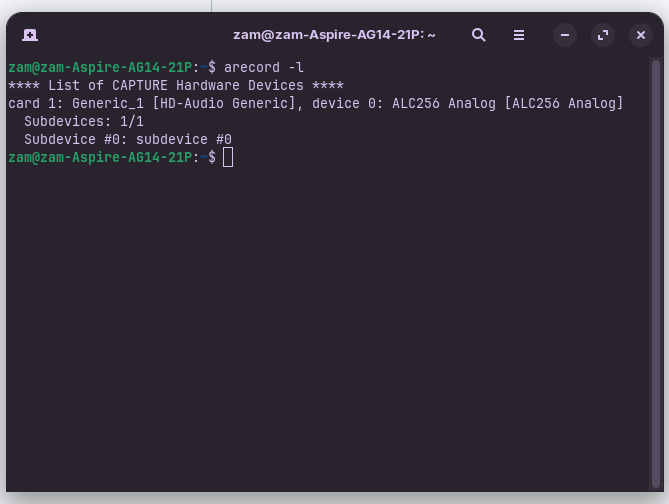

Could you run a
arecord -l

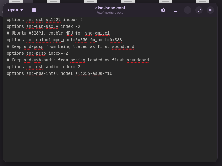

In the terminal and list the output? What I'm seeing that has helped some users on 24.04 is this post (https://askubuntu.com/a/1233446/1867383). Even though it is supposed to be aimed at 20.04, it seems it may work for 24.04 as well (which is what Zorin 18 is based on.
Same as my device , only mine is an Asus rather than an Acer. I think that link I shared in my previous post may be applicable to you. It's worth a try, as that seems to be what a lot of people are referencing with newer Acer devices.
I've just added the line to the bottom of the document and saved it, gonna restart now and see how it goes.
added that and rebooted. no change...
I see you selected the asus-mic option, which I don't believe would work if we're looking at your Acer machine? You could try a few different options, such as these two right in here:
As you're an alc256, it would possibly work with either of these two options (my laptop is dmic, but yours may be different). There's a few other options in the list that may be a choice as well, it may be a few diifferent options to try honestly.
