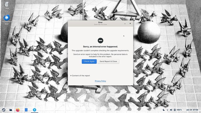

Hello again - I have a Lenovo notebook relative new with lots of capacity but I can't load Zorin 17.2 from "System tools." I push the button for 17.2 core and get this:
This operation seemed to go OK on my desktop computer at home but after reading helpful tip links about it, I can't make it work. What would you try?

I'm trying to load the "Upgrade Zorin OS" from "System tools". I don't think I'm there yet.
When You click on ''Content of the Report'' what do it show You? And when You make in the Terminal a sudo apt update && sudo apt upgrade does it show any Error's?

Thanks everybody. I did what you suggested but still get the same error flag. If I remember correctly, the only packages I added was Synaptic Package Manager and Screenshot.

[CHECKING:Updating Apt Repos] Fatal Error: { error-repo-download-failed: E:The repository 'https://ppa.launchpad.net/zorinos/apps/ubuntu jammy Release' does not have a Release file., W:Updating from such a repository can't be done securely, and is therefore disabled by default., W:See apt-secure(8) manpage for repository creation and user configuration details., E:The repository 'https://ppa.launchpad.net/zorinos/drivers/ubuntu jammy Release' does not have a Release file., W:Updating from such a repository can't be done securely, and is therefore disabled by default., W:See apt-secure(8) manpage for repository creation and user configuration details., E:The repository 'https://ppa.launchpad.net/zorinos/patches/ubuntu jammy Release' does not have a Release file. }
[CHECKING:Updating Apt Repos] Failed
[CHECKING] Failed
[CHECKING:Restoring System] Started
[CHECKING:Restoring System] Error: { error-repo-download-failed: E:The repository 'https://ppa.launchpad.net/zorinos/apps/ubuntu focal Release' does not have a Release file., W:Updating from such a repository can't be done securely, and is therefore disabled by default., W:See apt-secure(8) manpage for repository creation and user configuration details., E:The repository 'https://ppa.launchpad.net/zorinos/drivers/ubuntu focal Release' does not have a Release file., W:Updating from such a repository can't be done securely, and is therefore disabled by default., W:See apt-secure(8) manpage for repository creation and user configuration details., E:The repository 'https://ppa.launchpad.net/zorinos/patches/ubuntu focal Release' does not have a Release file. }

Okay, thank You for that. It looks like some Problem with the Repo's. With the Zorin Repo's. If I understand it right, the Program wants to update the Repo's to the Zorin Jammy's but that doesn't work. And then it wants restore the Zorin Focal Repos but that doesn't work either ...
Could You take a Look in /etc/apt/sources.list and /etc/apt/sources.list.d and then say/show us whats inside these? Of course first after You've slept.
