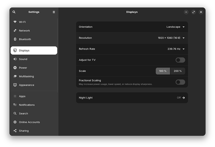

Capped at 240 hz for display on Zorin OS 18.1
I have a single monitor for my pc and for some reason even though my monitor is overclocked to 270 hz (max overclock 280), Zorin unfortunately caps out to 239,76 hz.
How can I make it so that Zorin uses a higher refresh rate?

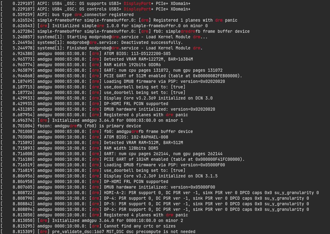

dmesg | grep -Ei 'drm|edid|displayport'

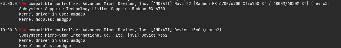

If 270 Hz is missing from xrandr, check the monitor OSD and turn its overclock setting on. Try another DP cable or port too. The EDID has to advertise the higher mode. Check the loaded GPU driver with:
lspci -k | grep -EA3 'VGA|3D|Display'
I would hold off on the GRUB video line until the connector name from xrandr matches. A bad mode line can leave you with a blank display.

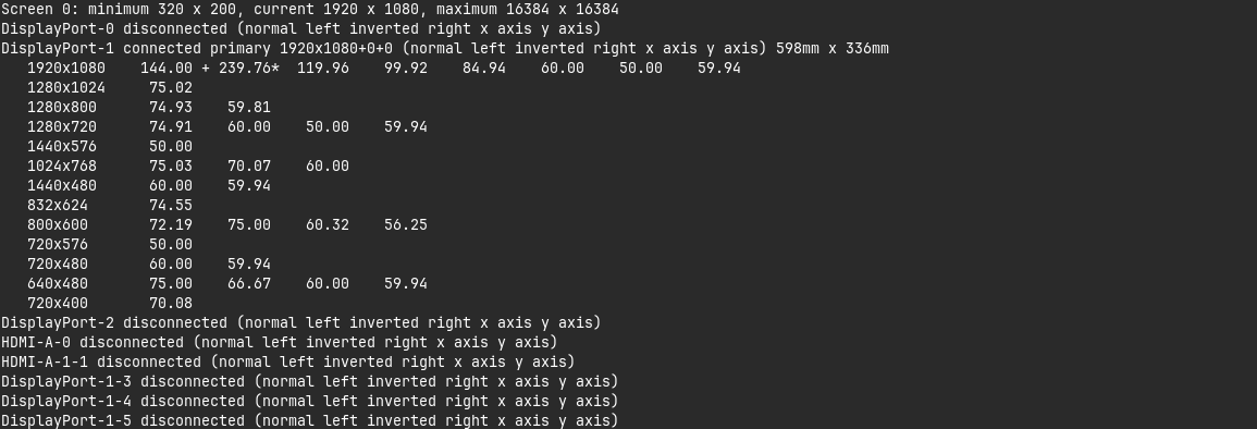

xrandr --query
The monitor is overclocked to 270 and it can go to 280 (but I leave it to 270 for good measure).
yeah ur edid only lists up to 239.76 on DisplayPort-1. nothing at 270 so linux never got that mode from the panel

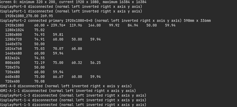

1920x1080 269.95 Hz (CVT) hsync: 343.38 kHz; pclk: 928.50 MHz
Modeline "1920x1080_270.00" 928.50 1920 2104 2312 2704 1080 1083 1088 1272 -hsync +vsync
xrandr: failed to parse '1920x1080_270.00' as a mode specification
Try 'xrandr --help' for more information

I did those but uhh now what?
if those 3 cmds ran clean u should already be on the 270 mode. check:
-xrandr | grep DisplayPort-1
want a line with 1920x1080_270.00 and a *
to keep it after reboot, drop a tiny autostart that runs those same 3 xrandr lines after a short sleep ( ~/.config/autostart/xrandr-270.desktop ). if login blanks, delete that file and boot back to stock 240.

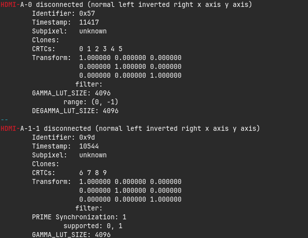

grep hides the mode lines (they dont carry the connector name)
just run:
-xrandr
from ur earlier paste the 270 mode got created but u were still on 239.76. pick whichever DisplayPort says connected primary then:
-xrandr --addmode THAT_OUTPUT "1920x1080_270.00"
-xrandr --output THAT_OUTPUT --mode "1920x1080_270.00"
want the * sitting on 1920x1080_270.00
