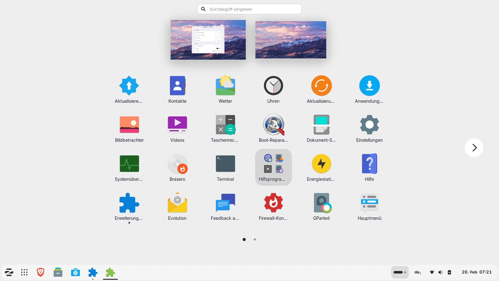

Zorin newbie here. I have set Zorin 18 to the Mac layout and would like to change the size of the icons in the main app grid. I can´t see how to do that. Is there a way?

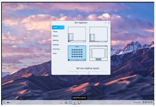

So are you using Pro? Only Pro comes with the MacOS layout, unless you are thinking of this one:

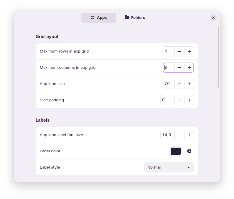

You can try these gnome-extensions:
First install extension-manager
sudo apt install gnome-shell-extension-manager
then open it and go to tab "browse" to search for the extension and to install it.
After the installation go to tab "installed" and click on the cogwheel at the extension to make the settings. With both extensions you can adapt the icon size of the app grid.

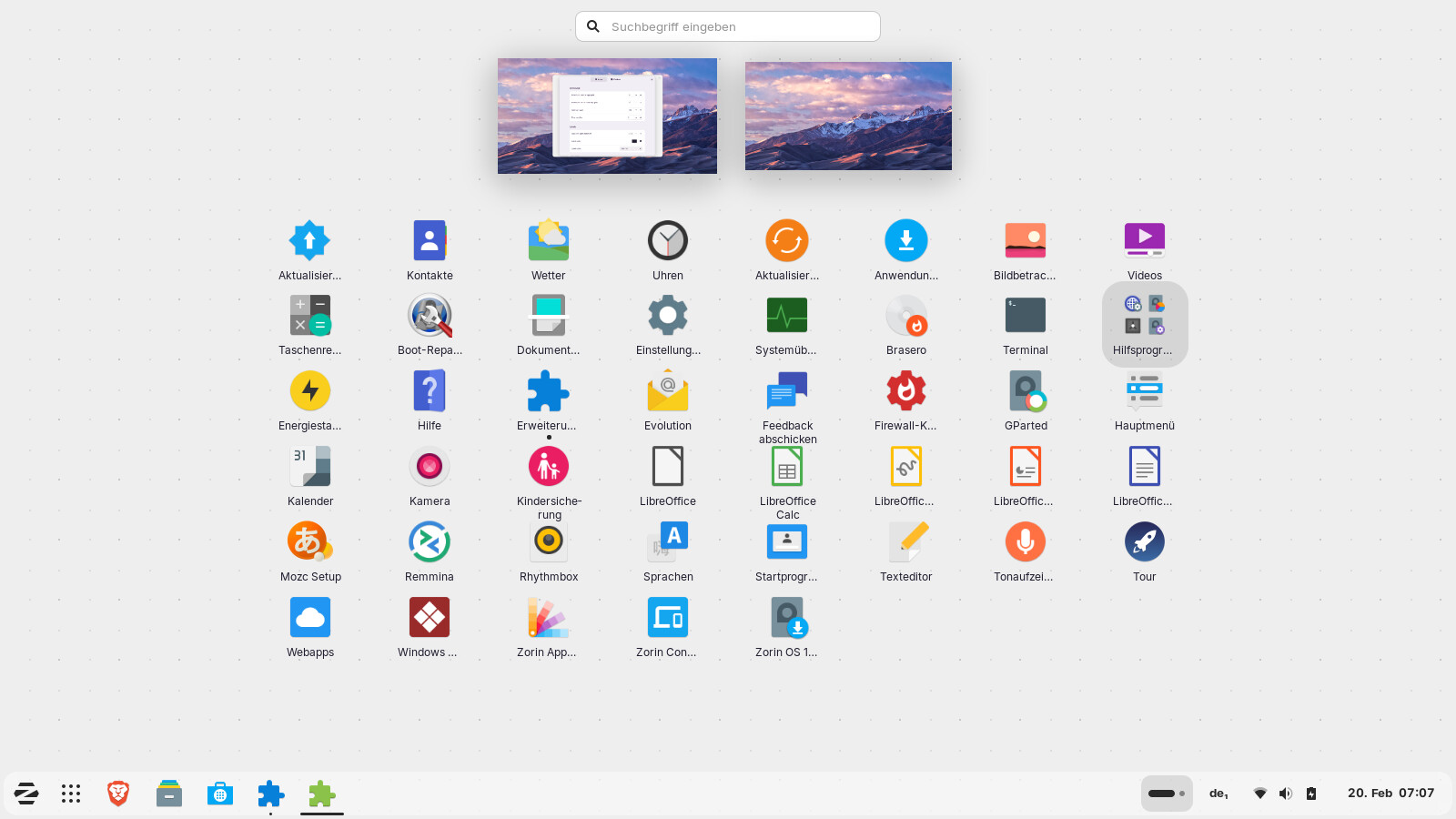

I´d recommend app-grid-tuner, v-shell has some conflicts with the Zorin extensions. You can set up the rows and columns with this extension, the icon size, side padding, font size and font color.
