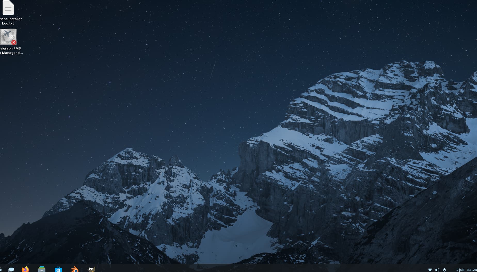

I changed my old NVIDIA 970 by a brand new 4060. Everything went fine but when i log in (X11) the desktop in cropped :
I tried to change 550 driver by 570 but nothing change. If i change to a lower resolution i don't have the problem. I am not technical and really don't know what to do.
Any help welcomed
Chris
ps: i am using a TV screen not monitor
Found the solution in the LG TV settings (format issue)
Which resolution is cropped for you, and which is working? If they're different aspect ratios (the ratio between length and height is aspect ratio), it's probably trying to use an aspect ratio that doesn't fit your TV. 16:9 and 16:10 are both fairly common.
