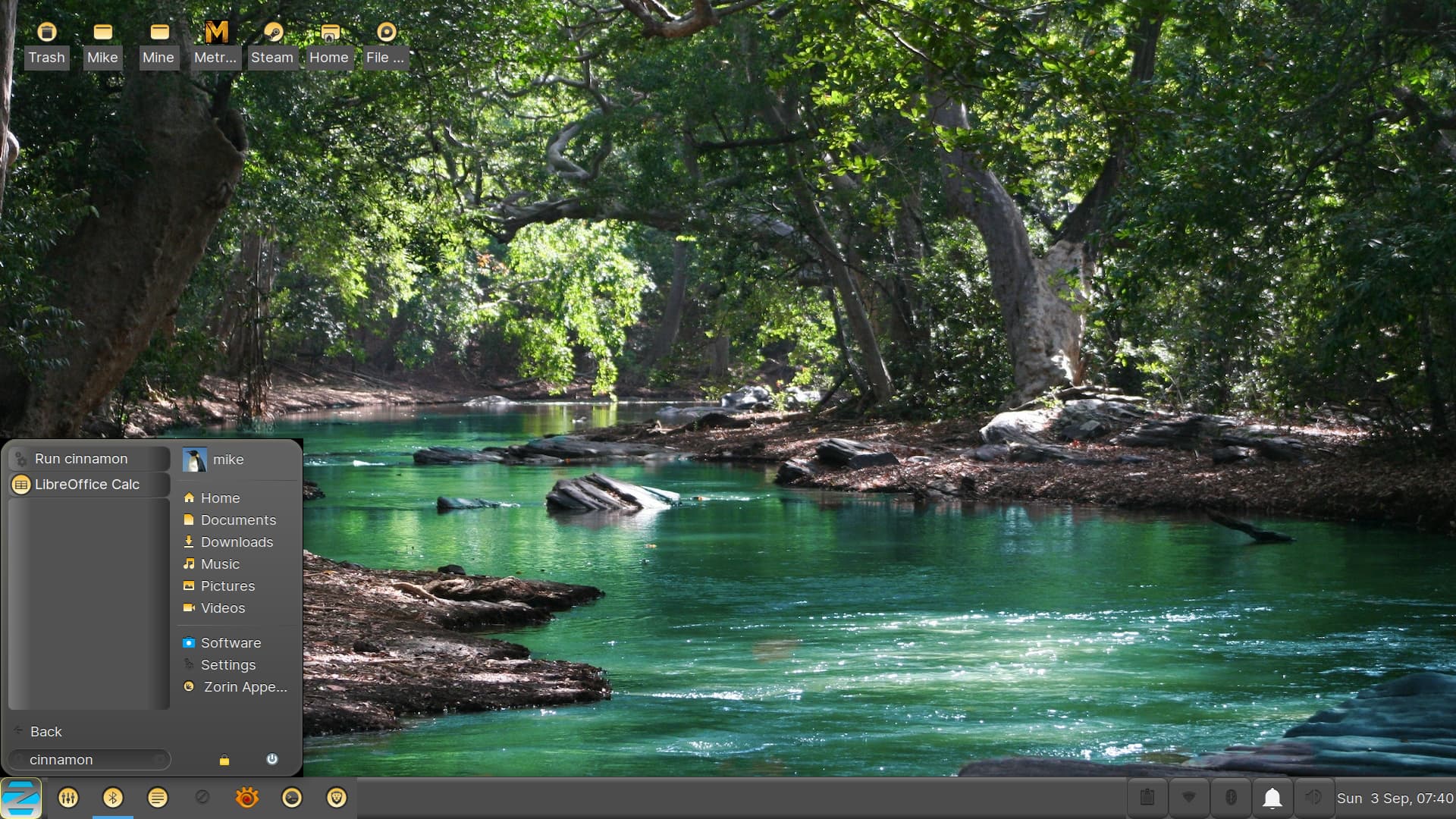

Well I tried ...... $ sudo apt install cinnamon-desktop-environment ...... from the Ubuntu 20.04 instructions and sudo apt install cinnamon ..... but neither one appear to have worked ..... it doesn't show up in my login drop down list but does appear in my Zorin Main Menu .....
But clicking on that just causes it to disappear with no results ....

I'm back on Cinnamon but I think it is 16.3 or at least that is what neofetch says .... but then I think you told me that neofetch can't distinguish between the versions of Zorin ....

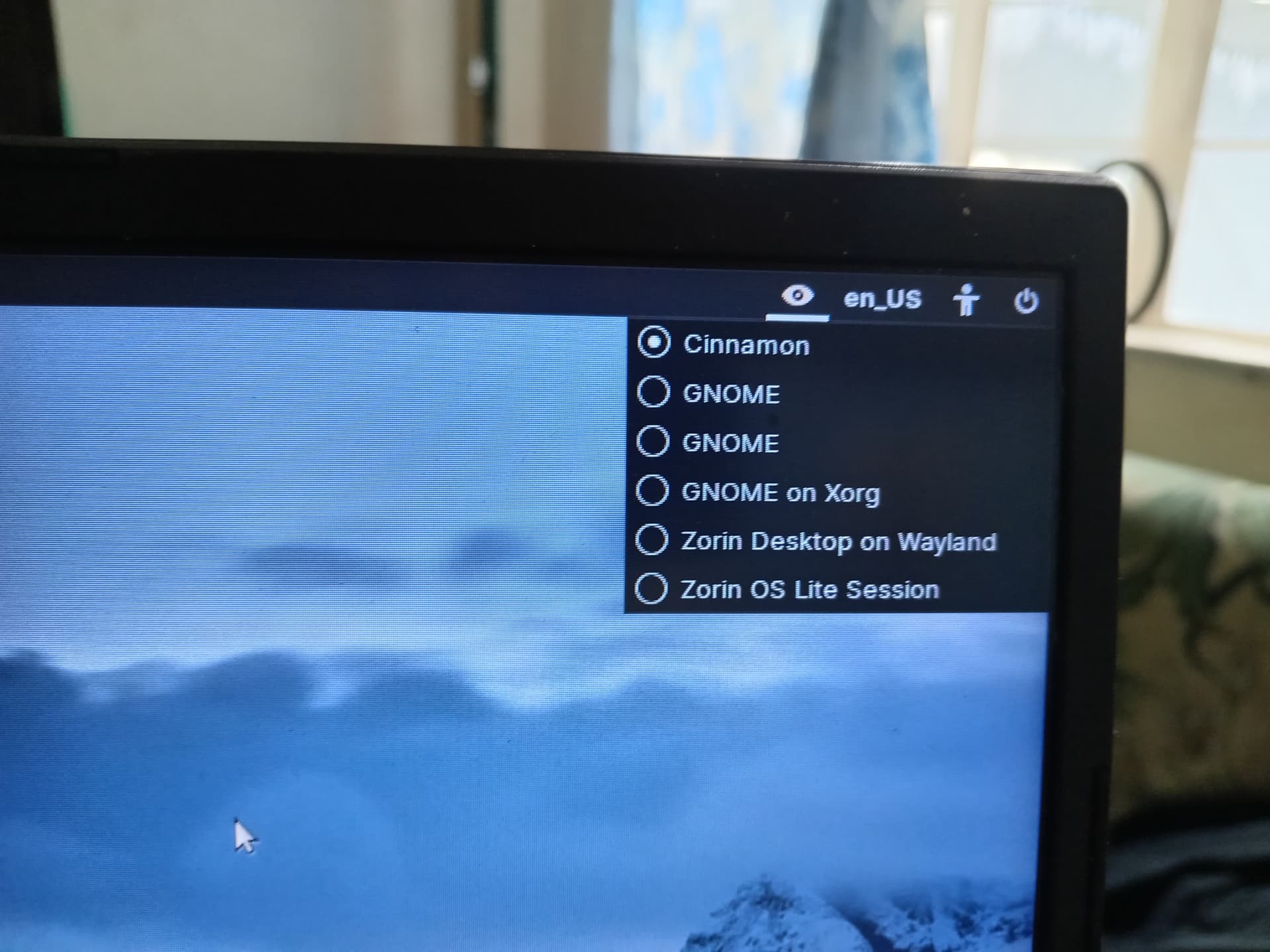

then it should show at the Login Chooser
I have Cinnamon in Login Chooser ..... and I have chosen it now and Cinnamon is running but is it running on Zorin Core 16.3 Pro or Zorin Pro Lite ..... or does it matter ????? .....

Done ..... now if you would be so kind as to give me the path to remove the extra icons from my Login Chooser again .... I can find the post it was in ....

Rats ..... it won't let me delete any of these .... delete is grayed out ..... I think I tried that last with the same results ....
Elevate to Root, first
sudo -i
nemo
Navigate to /usr/share/xsessions
Once again you fixed what was broken and I thank you very much .... it helps a whole bunch just not seeing them in the Login Choosers .... not sure just why I have 2 versions of Gnome showing as it only shows one icon but it is a whole lot better that the 9 entries before .....
Thanks again
Check if you have a /usr/share/wayland
directory. It may contain one of those Gnome entries as a .desktop file as well.
You can remove that one, as well.
