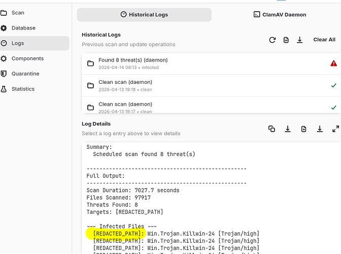

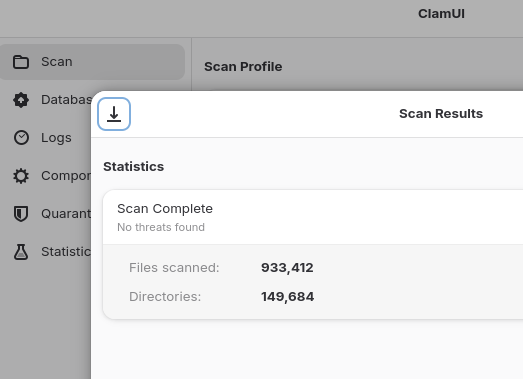

I have installed CLAM AV and it is running on a schedule. Today a pop-up said infected file found. They are probably very old files from the mass of files I imported from windows. I still would like to know which files they are. The problem is when I look at View-results it says no threats found, but then under Logs I see the notice of 8 infected files. Worse, in the details is lists the malware name preceded by the string [REDACTED_PATH].

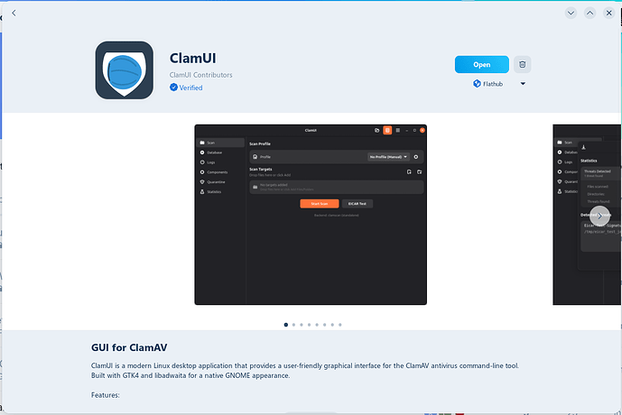

there is a better way in software store look up clamUI its way better and quarintines automaticly

Having seen it before I turned on "quarantine automatically" and ran a "full scan" and like before it says no threats.

  1. I have no idea how these two searches are different and how the one running in the background is different?
  2. Why is the path redacted?

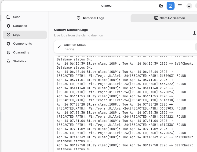

When You click on ClamAV Daemon at the top right what do You get there to see?
Thanks for your reply.
I have scrolled down to the bottom of the window where malware is reported.
The exported-log is available but seems I cannot attach it here.

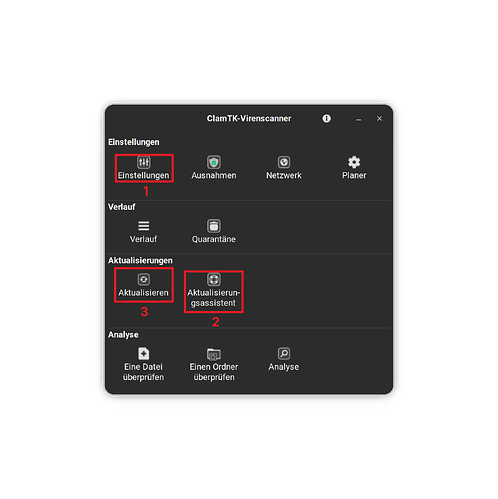

Open the Terminal and type sudo apt install clamtk for installing the ClamAV graphical Frontend ClamTK. It is an old Project but for Double-Check it is fine. When installed, open it and open the Settings. There activate everything.
Then open the Update Assistant and set it to manual Updates. Then click on Updates and update it.
When You have set everything up, choose the Option to scan a Folder and there choose Your Drive and let it make a whole Scan. This can take a lot of Time. But when it is finished, You get and List Output where You see the Files and the Threats.

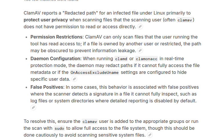

Meantime I found this:
If you find anything actionable in it, do let me know.
Well, that reads like the Answer relates to the Fact that ClamUI is a Flatpak and have limited Permissions. Also the False Positive Point is a Possibility, too. But this all falls back to ClamAV directly. So, when You use ClamAV (or clamd) directly to scan something.

There is also a .deb package for ClamUI on github:
I posted a tutorial in the post that brought ClamUI to the forum's attention and I posted the commands on what to run without the need to go to the GitHub page with the one exception of acquiring the .deb package.
It requires that you uninstall ClamAV and the Flatpak and start from scratch.

update: After having turned on quarantining, today's scan shows the path/filename; it was not anywhere exotic: a subfolder under /Documents.
The identification is surely a false positive since these are zip files of installation package of software I myself wrote way back in yr 2002.
I had missed the Quarantine switch, because it is half-hidden away in the menu in the title-bar and why are there effectively two menus in this program?? (rhetorical question)
