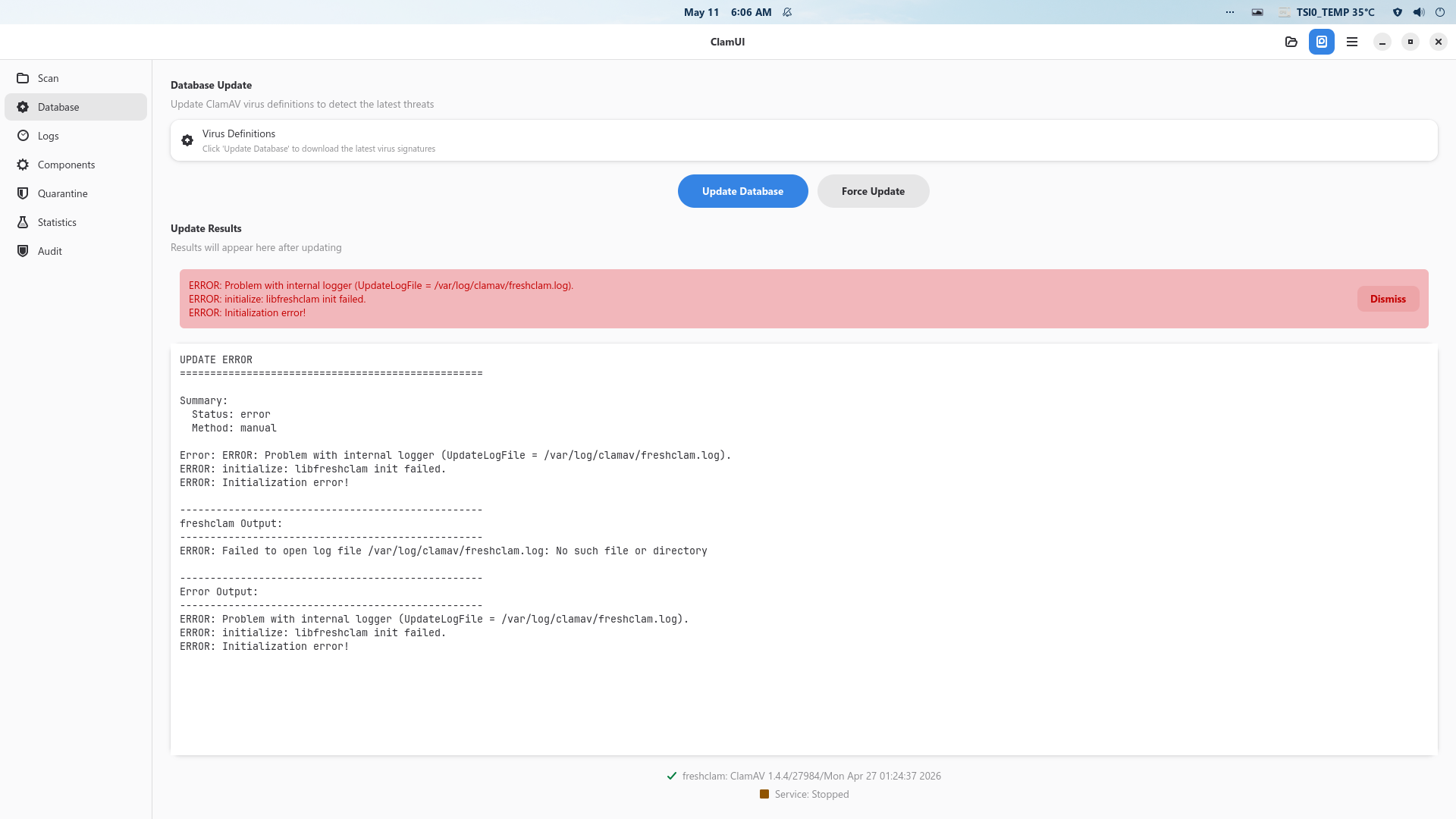

Clamui error
well i got this error now on clamui clamav is installed but i cant seem to fix this any suggestions? Thanks in advance all
Have you installed clamav from the repositories as well?
it was working yesterday i have removed all and reinstalled clamav without the UI and got it working and have it scanning but the UI fails not sure what happened but clamav is functioning
I do remember an update to it yesterday...wondering if there was an error in the new update? Hmm that maybe it clamtk is working fine and i can scan with it as well

ive looked in /var/log/clamav/freshclam.log the clamav and freshclam.log isnt there
is there a way to create the log file?
ok after messing around for quite some time i grabbed the ol clone drive and cloned back to where i made that then removed the clamui before i did anything added in clamtk...restarted system opened clamtk did an update..it did then tryed to run sudo clamscan with the proper stuff after it updated and started running problem has been sloved...thanks all
