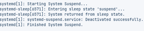

Also, could it have an issue with Windows dual boot? The log for the suspension says it went fine. The system does go into suspend, but starting it back up doesn't seem to work

No, I suspect not. Freezing on wake is an old and pretty common problem.
Many things can cause it - due to it primarily being a hardware vs. driver compatibility issue : Graphics, Motherboard or Firmware...
So common things to try include
  • A different Kernel
  • Different Graphics driver (Primarily a Nvidia thing)
  • Applying BIOS firmware updates
Or
Applying kernel parameters if we can narrow down the hardware causing the issue. For example, using the nomodeset parameter if it is a graphics driver issue for which no driver brings a fix.
