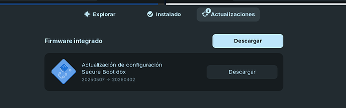

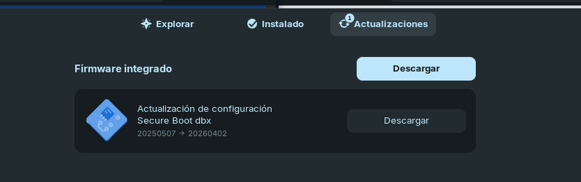

2. Trigger Event & Package Details
  • Update Name: Secure Boot dbx configuration update
  • Version Transition: 20250507 $\rightarrow$ 20260402
  • Delivery Method: Zorin OS Software Store (GNOME Software)
