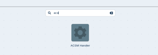

When I search for the application, it's found and I can start it without problems:
