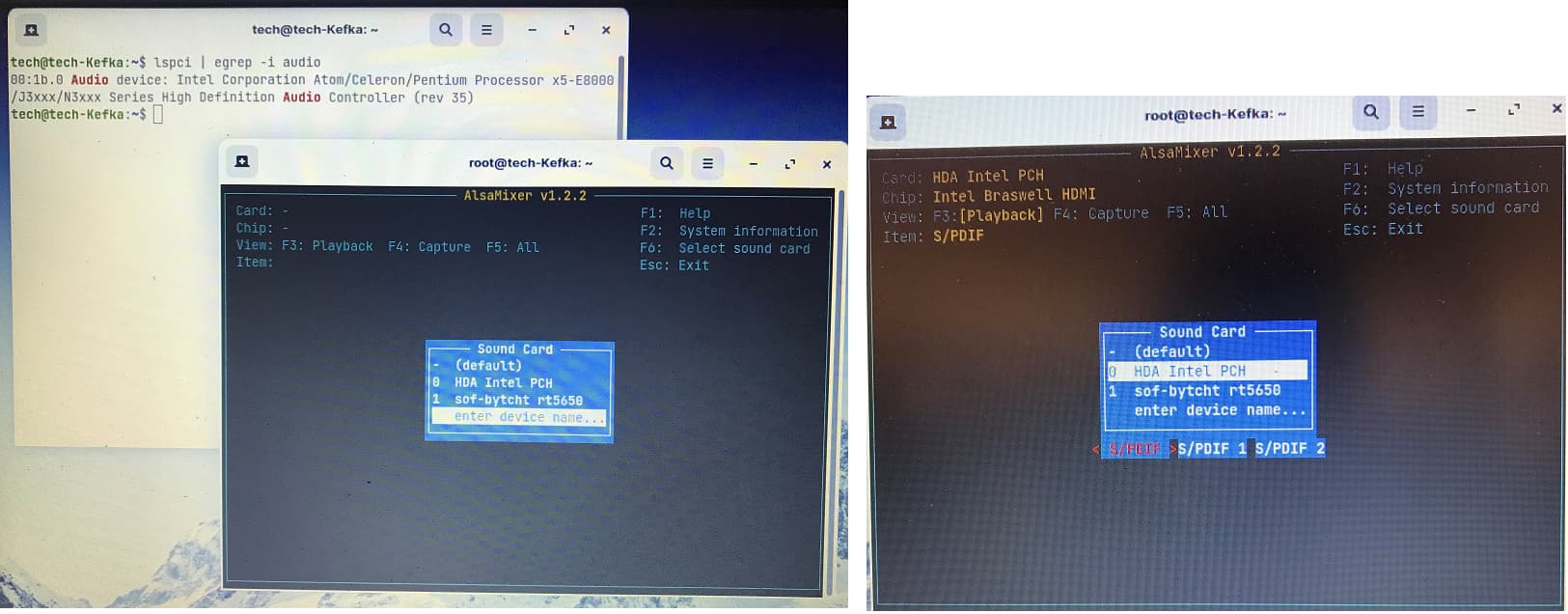

Run
lspci | egrep -i audio
And relay the result here, please.
You should see something like sof-xxxx####
Open Alsa mixer elevated to Root
sudo alsamixer
tap F6 to select your card that you identified above.
Now, in a terminal window, run
sudo alsactl store
Reboot and test...
There is only two to select
Whether I select 0 or 1 I get no sound
Also, is there some way to "save" the selection ?
Or do I just exit ?
Yes, exit with your selection chosen, then save it with
Choosing 1 should be the correct method.

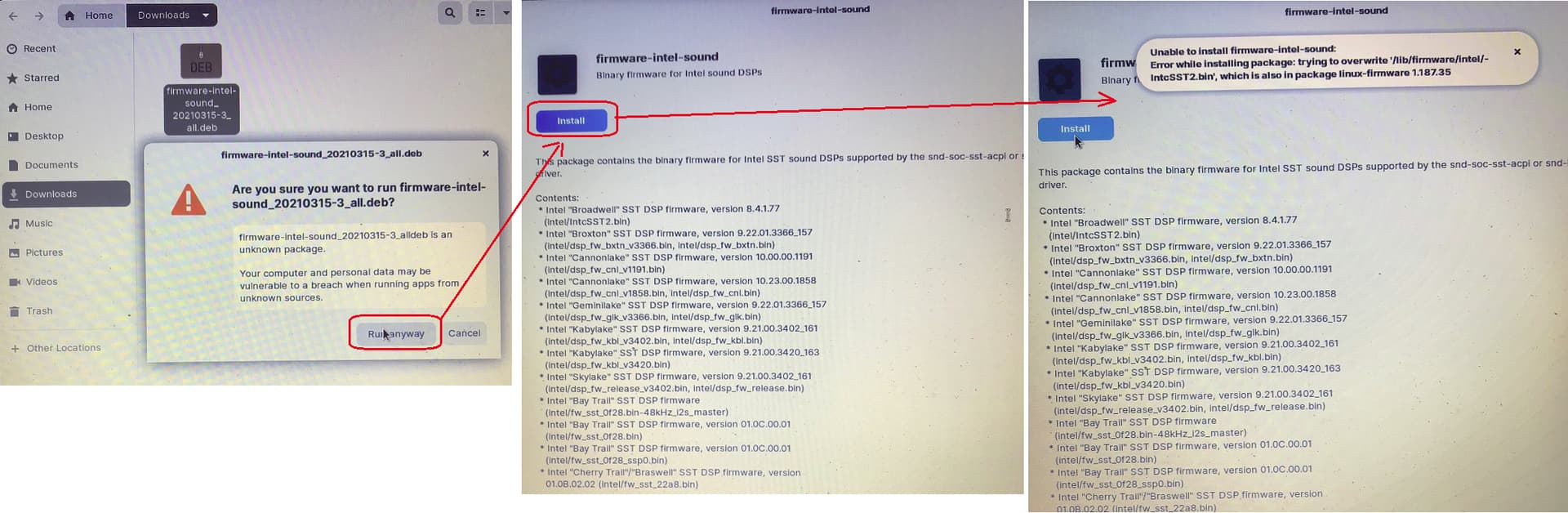

You might try installing the NonFree Firmware
http://ftp.de.debian.org/debian/pool/non-free/f/firmware-nonfree/firmware-intel-sound_20210315-3_all.deb
I tried to run an intall by double clicking the .DEB file but I ended-up with the following error:
"Unable to install firmware-intel-sound:
Error while installing package: trying to overwrite 'lib/firmware/intel/-intcSST2.bin', which is also in package linux-firmware 1.187.35"
I also tried to run the install from Terminal but received a similar error
