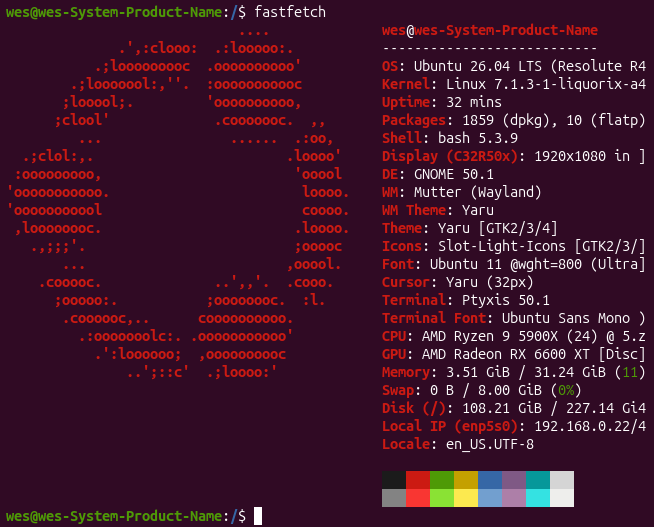

Ya i had another error with firefox clicked to open it screen went black with the left screen full of error codes had to power off to even restart not sure what happened..isnt doing that on other OS i been testing..which i am currenty logged into...lol that was only trouble i am having zorin OS 18.1 has been working fine till a few weeks ago no biggy
current testing
