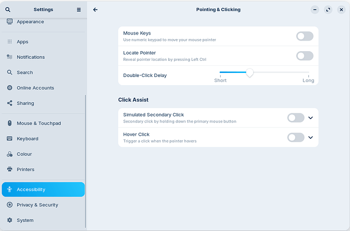

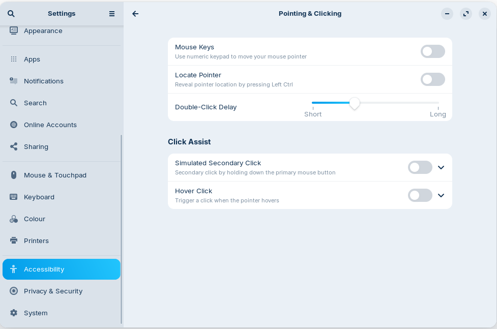

Hi @QuetKetiapin , could it be an issue with your accessibility settings?
if you go to Menu > Settings> Accessibility do you see the same as my screenshot above? Maybe you could try and increase the 'double-click delay' to be a bit longer?
You can also go to the Mouse & Touchpad settings > Test settings to see if your primary click is wrongly recorded as a double-click?
Hope this helps.. Personally I have had no issue with the two mice I've tested.

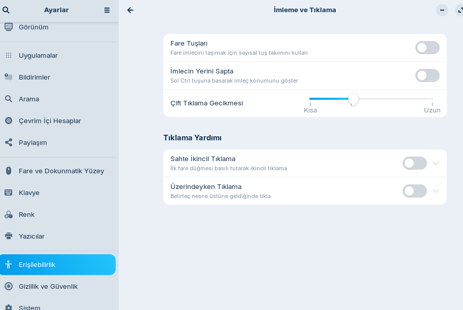

Hello,
In the settings section, it requires individual touches. But when opening folders, it opens them directly.
My other settings are shown in the screenshot.
I still haven't solved the problem.
Thank you very much.
That's useful to know! I think this is just a setting. These other users had the same problem as you:
The first link says to:
"File manager -> hamburger icon -> settings -> behavior -> Top item is single/double click option."
Hope this helps!
