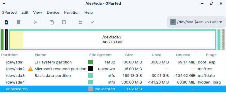

Also I'm not sure what to delete. Gparted shows a lot of small partitions which I don't recognise which may not be relevant to windows 7.
I won't touch the EFI fat32 one which must be the boot partition but can I just delete all the others?
I was thinking of ending up with sda1=boot, sda2=windows 7, sda3=zorin os, sda4=home. Does that seem ok?

OK, So EFI system partition is needed for secure boot - Windows has only allocated 100 Mb. When preparing for GNU/Linux, this should be 512 Mb.
sda2, Microsoft reserved partition - this is usually for Drivers for your hardware.
sda3, Basic data partition - I always fall of my chair laughing at this because GNU/Linux is naming where Windows lives!
sda4 is your Data.
