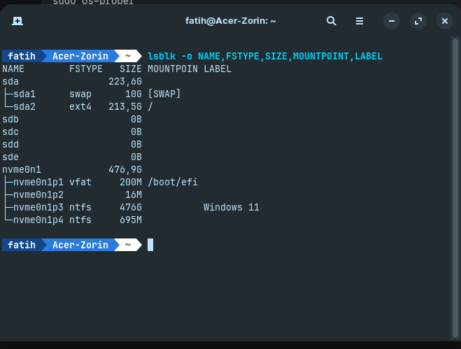

After the Zorin update, Windows disappeared from the group.
Secure boot is disabled.
Windows fast startup is disabled.
In the BIOS, Zorin OS and Windows Boot Manager are available for boot.
Dual boot was working before the update.
Can You start from there in Windows or does this not work? I ask to be sure that the Boot itself works. When it works, I would suggest to try it with Boot Repair. Start Zorin from the Bootstick and choose the Option ''Try Zorin'' to get in Live Mode. There look for Boot Repair and let it run.
I fixed it with Boot Repair, thank you.
