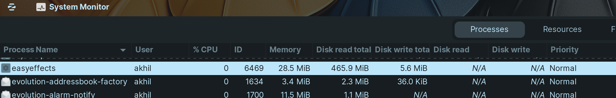

When I checked the System Monitor, I could see that the easyeffects process is running! Then why is the UI not opening?

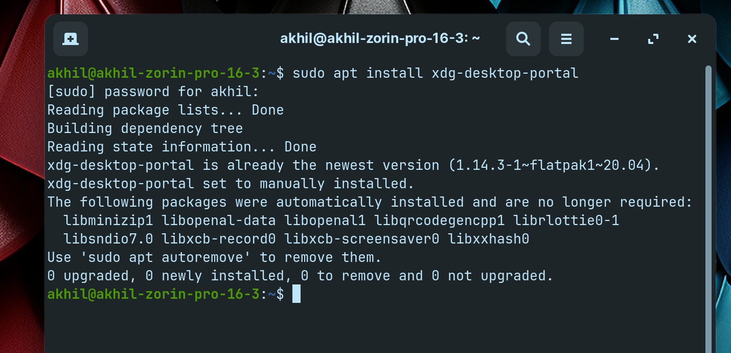

Can you please run in terminal
sudo apt install xdg-desktop-portal
reboot and test the Flatpak Application.
Seems it's already installed and the latest version.
