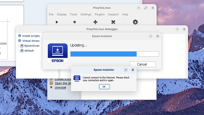

So I just tried to install play on linux to see if I can get a .exe file to install. Its for a windows driver to an epson scanner. Whenever I click the file to run, it looks like its about to and even though my wifi is working just fine, I get an error message that the file can not connect to the internet!!! UHHHHH!!!

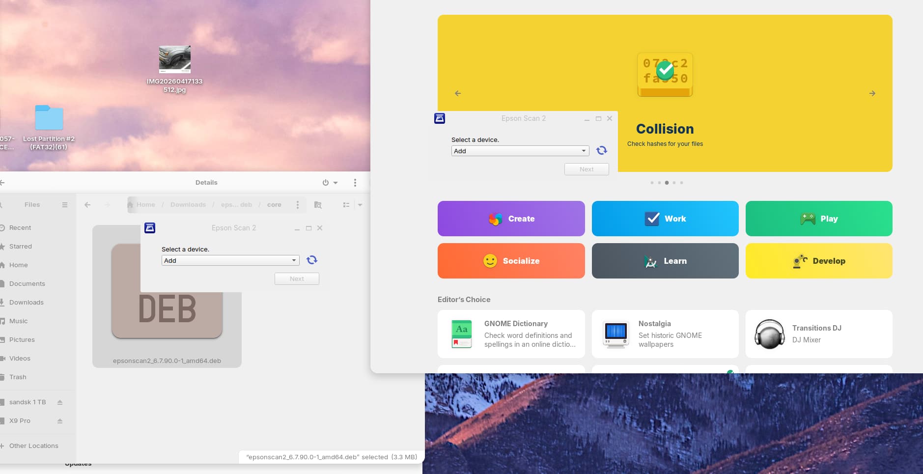

Thanks for that simple set of instruction! Very appretiated especially since I'm heavily doubting myself these days with this latest complication. The attachment is a screenshot after I downloaded that file again ( I have downloaded that several times and hasn't yet worked) showing a greyed out "next" button that doesn't let me move forward. It seems like the terminal command may have done something but while my scanner is plugged in -nothing seems to happen just yet. ( i will try rebooting now)- In the meantime- my attempt at installing Winboat is still looping around here wasting money in electricity.
That looks good. Now click on your start menu and enter epson.
WOW ! Thanks!! My scanner was plugged into one USB port that for some unknown reason doesn't connect. I reconnected with another port and NOW it seems to work! THANK YOU!!!!!!!!
