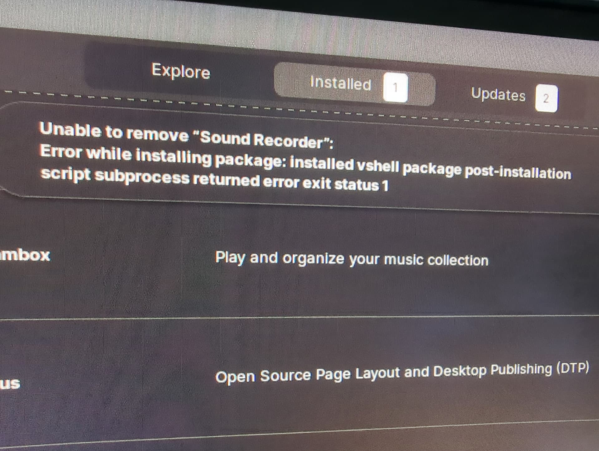

Hello i have a problem with removing or installing a program. In the Software store. I get the following error code
Unable to remove "Sound Recorder (any program)":
Error while installing package: installed vshell package post-installation script subprocess returned error exit status 1
see picture
