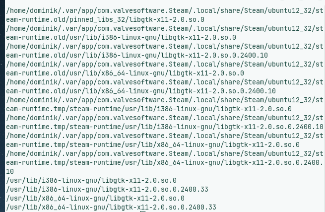

and it appears libgtk-x11-2.0.so. already exists in the latest version.
When i try to locate it, it also seems to be there.

It is installed as Flatpak not as .deb/APT:
I think this is what was @Storm about. I would suggest to try the .deb Version - but uninstall the Flatpak Version before. You can download it directly from Steam:
