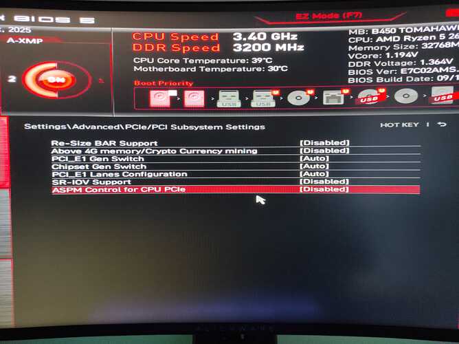

I had a look into the BIOS and these are the settings related to PCIE - anything I should try to change?
That setting you're highlighting appears to be relating to the CPU, we don't want to be touching that one. I don't know the model of this motherboard exactly, but how many pcie slots does it have? In theory the setting you'd be looking to change should be able to change them independently of each other (if it allows it)

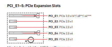

According to manual, there should be 5:
  • 1x PCIe 3.0 x16 slot (PCI_E1)
  • 1x PCIe 2.0 x16 slot (PCI_E4, supports x4 mode)
  • 3x PCIe 2.0 x1 slots
Ok I see now. So your top slot is your 3.0 slot, and your bottom slots are rated at only version 2:
Which this would indicate that you would need to install this adapted into your top slot (E1) in order for the card to function. If it's currently in the bottom slot (which it probably would be if you have a graphics card) then it probably wouldn't function.

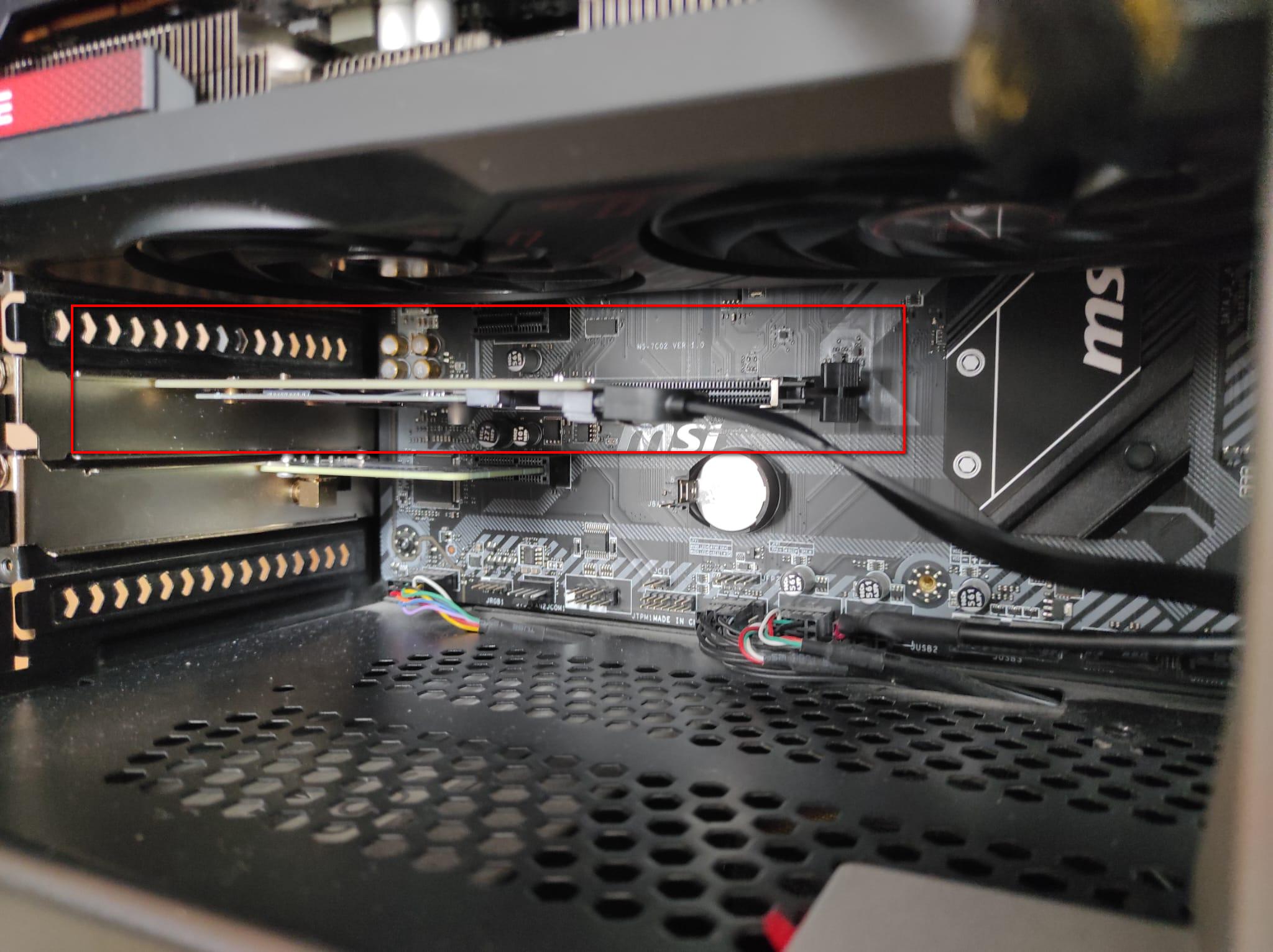

Currently I have the expansion card it E4, because that is the only one where it fits, it is too big for E2, E3 and E5.

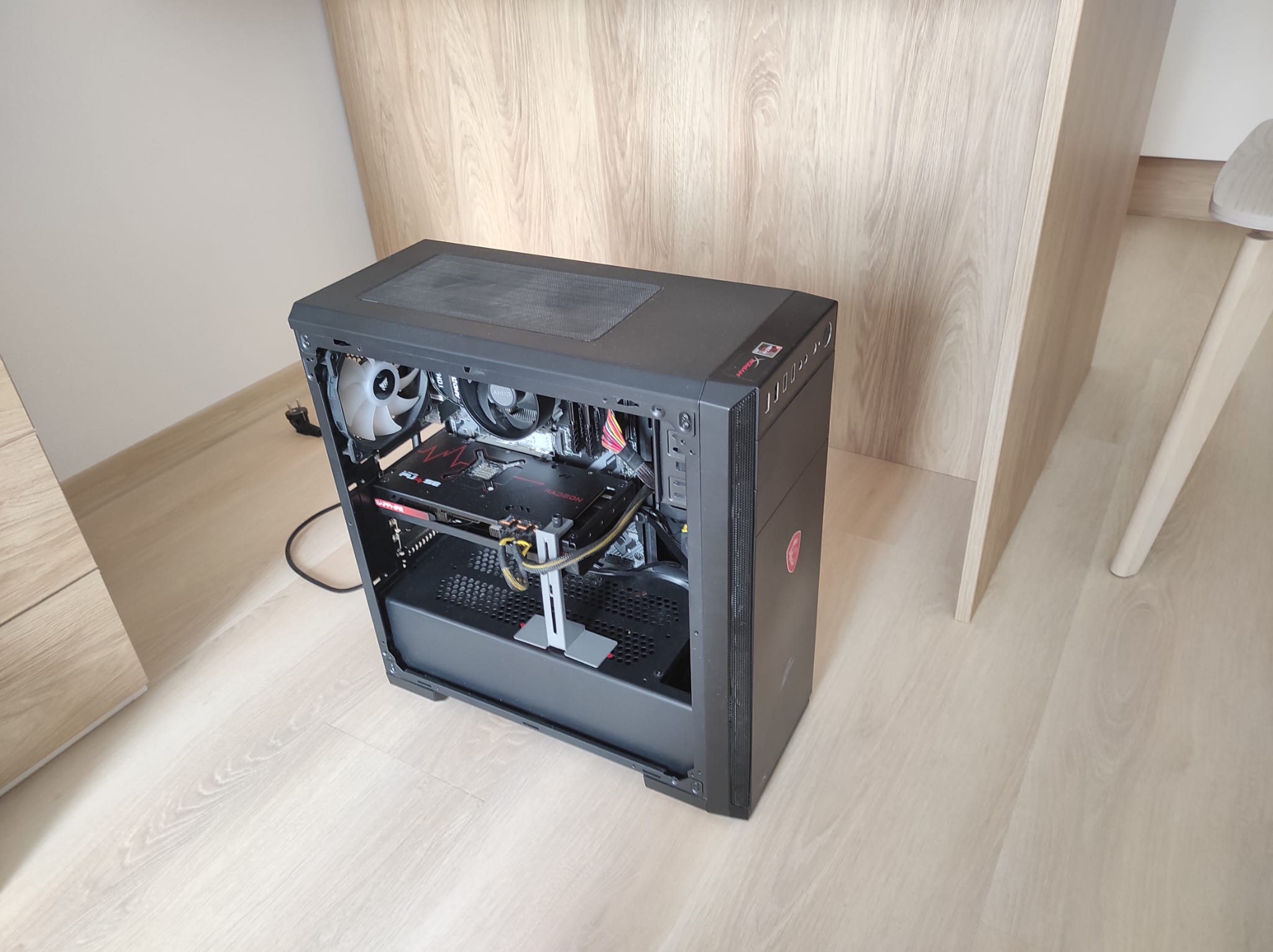

Well, if the Case offeres the Place, You could simply take 2 SSD's and put it in the Case on the Mounting Positions for Drives. What Case do You have? Because Your board is an MSI B450 Tomahawk, the Board is an ATX Board. So, You need a bit Space.

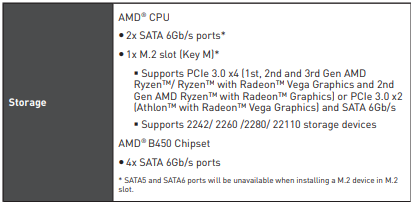

From the manual it appears you have one m.2 slot presently (key M) along with another 6 sata ports.
You could grab a couple of Sata ssds and use them through the sata ports. You will still notice a massive difference compared to a traditional hard drive in terms of system responsive by a massive factor. Just because they don't use NVME, don't count them out on their usefulness. They're also cheaper than NVMe drives, which is a plus in my books.

On further thought, since the card is a PCIe to SATA adapter card, it should work in the E4 PCIe slot - no direct SATA bus access would be needed. (SATA access IS needed for m.2 slots on the motherboard for SATA m.2 drives. Not the case here.)

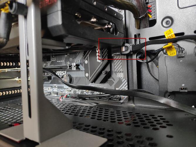

Did you remember to connect the required power cable?
I did, I found one free slot near the the other cable which connects to another HDD, so I hope I connected it properly, but it is connected.
Adding some pictures to show it. + @Ponce-De-Leon was asking about the case - it is on pics too.
It is a big Case. I guess, You should find a Place for the Drives.
