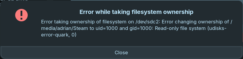

If you have only datas on the drive and no OS you could try to open disks and take ownership of the partition of the external drive. Be careful to select the right drive!
The OS is on an internal SSD, the Drive I am having trouble with is an external one with just data/files.
Following the instructions to take ownership gave me this error.

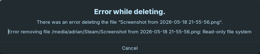

Trying to delete an old image resulted in the exact same read-only file system error in my previous post.
