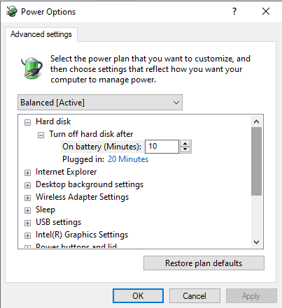

I'm just talking about automatically turning the drives off after a period of time so they'll automatically spin back up when you try to access them. It's standard power management stuff in WinBlow$ but power management in general in Zorin seems to be very vague.

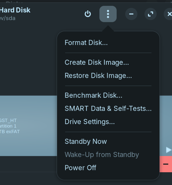

I found a way but it's not automatic. If you start the "Disks" application in Zorin. Click on your hard drive, there is a "Standby Now" button in the three dots menu. If you click on it, your hard drive will go to sleep. If you start using your hard drive (aka accessing files on it) or press "Wake-Up from Standby" from the same menu then it will be back online.
